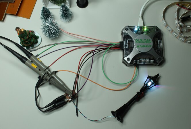

A set of street lights with no lights!?
As far as I can tell they were designed to include a light source, as the pole is hollow and the base cap has a slot for a wire...
For those of us that know how to solder, there is an easy fix... An LED!
I decided to splurge and use an addressable programable LED (a ws2812b)
I soldered a wire to each of the 4 pins and added a dab of hot glue.
Before
After
Huge improvement!

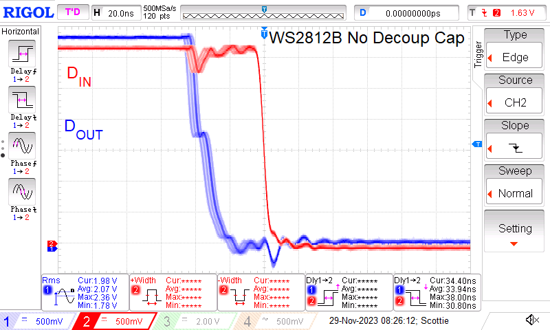

Those in the know, might have noticed I didn't add a decoupling capacitor to the ws2812 neopixel.
I'll try to post a scopeshot of the output dataline to see what kind of trouble the IC might get into (or not) with the omission of the decoupling cap...

    Thanks for the kind words, the end result is quite illuminating....
  • scottiebabe
    scottiebabe over 3 years ago in reply to fmilburn
    Thanks for sharing your experience. My instinct is that for a small run with twisted leads it will probably be okay.. This IC runs the LEDs with constant current sources and the protocol should tolerate a brief glitch. I wouldn't recommend a long string with no caps but I am guessing a 30 cm hookup cable isn't going to be the end of the world.

    Thanks and yes! I am using the DD partly because its already setup also because I am interested to see if I can spot any funny business with the omission of a decoup cap.
    The waveforms is maybe a little bare bones on the digital side, but in general I think its a great product.
