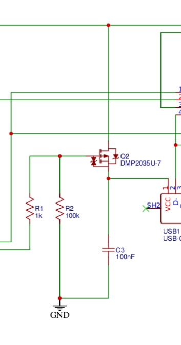

    My dream project is taking an idea and making it a reality without having to learn through failure... case in point... my first failure of the year... and now I know all about p-channel mosfets...
    And note to self... do not take up an old project between Christmas and New Year... your tummy is still full of Christmas turkey and the brain is not fully engaged. Boy oh boy...

    If your voltage originates from pin 1 of the DC connector everything seems correct to me.  Pull down resistor R2 ensures a negative VGS to turn Q2 on by default.  R1 I assume is connected to a signal that turns off Q1 when a positive voltage is present.  So I don't see the error... but maybe my mind is also still sleepy from holiday times.

    I have drain and source reversed. Also, source voltage can be greater than 5V, which is not good for most 3V3 MCU's driving the gate - I also forgot to add in a transistor for this purpose.

    One more question.  The USB connector pictured at the bottom of your schematic, is that the source of the 5V supply... or is it receiving 5V from  elsewhere on your board?

    So the USB connector pictured at the bottom is receiving 5V, or if it's a USB-C connection, or say for a phone, it could be 9V or even higher.
    For a bit of background, this was the original forum post I created a good while ago when I was seeking guidance about this little project of mine:  For FET-sake, I keep switching and cannot find a suitable MOSFET (or BJT)

    Okay, if it's supposed to receive then I see what you mean about source and drain being reversed.  It's only occurred to me just now how plumbing can serve as a good analogy for P channel MOSFETs.  Its source generally connects to a source and its drain connects to something down stream.
