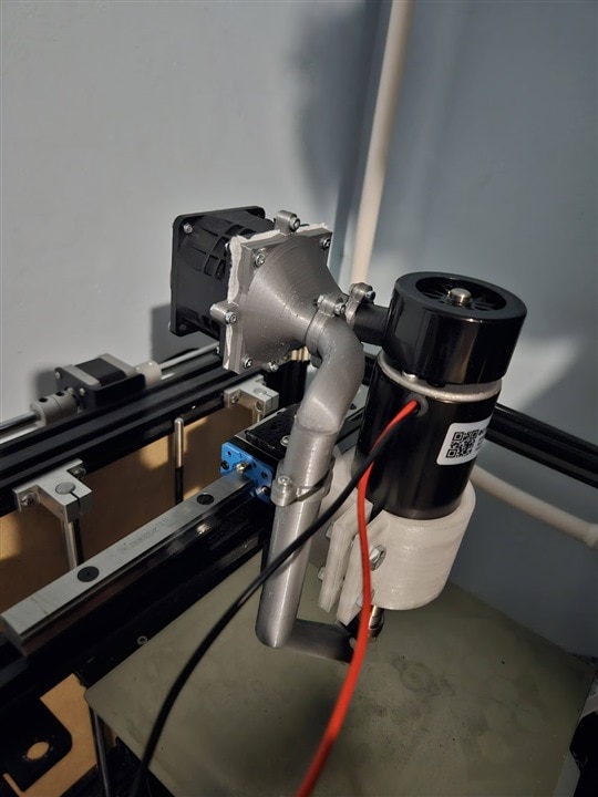

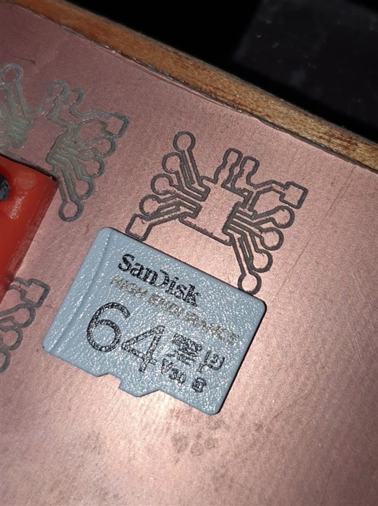

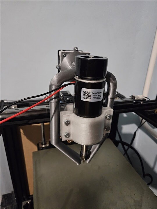

    vmate over 1 year ago
    Not quite the type of tool you probably thought of, but I made a PCB mill toolhead for my 3D printer, so I can quickly make adapters and other small boards, without having to wait a week for a proper PCB fab to do it.

    anniel747 over 1 year ago in reply to vmate
    What's the white stuff protruding near the fan?
  • electronicbiker
    electronicbiker over 1 year ago in reply to anniel747
    Referring to the picture on the left, it looks to me like a slightly oversized circular filter or gasket between the miller motor and the fan above it. And now, I'm REALLY guessing - The fan forces air down through the filter and motor, and then blows it down onto the workpiece to keep the milling tool cool. The two angled tubes, obviously from a Cyberman's helmet, suck the debris-filled air upwards to prevent lung cancer caused by breathing fibre-glass and copper nano-particles. The partially-hidden device at the back that looks as if it is bolted to the wall could be a combined suction device and a fibre-glass dust collecting unit such as a polythene or nylon bag with a very fine mesh - the centre picture shows it better. The picture on the right shows a perfect result, so well done anniel747! I'd be interested to read what you tell us!

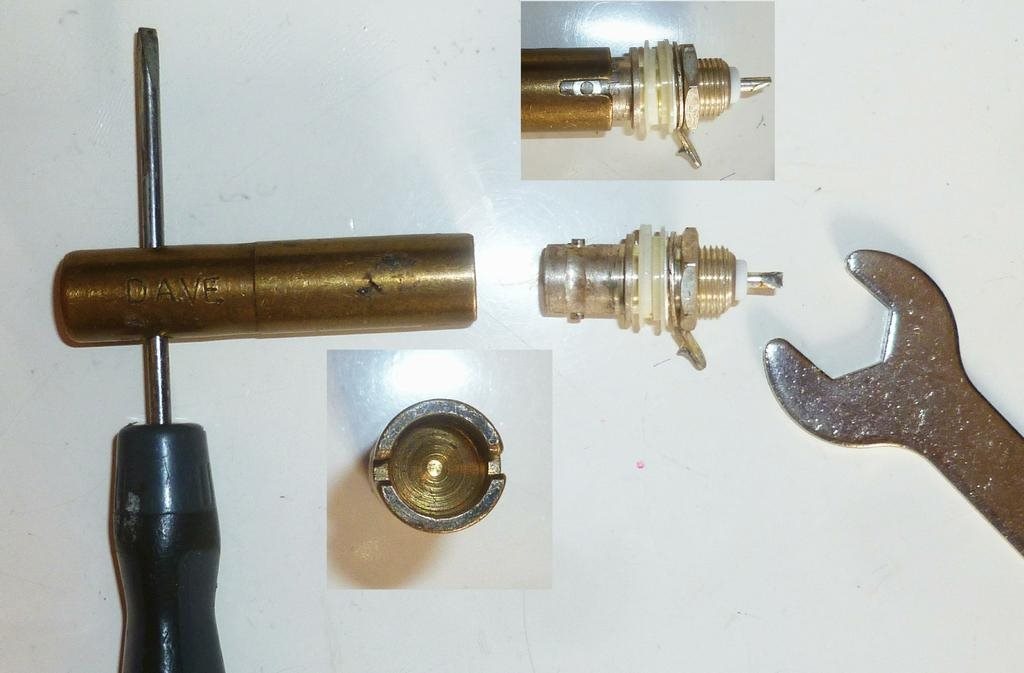

    davebullockmbe over 1 year ago
    In the days when I was building equipment with myriads of BNC connectors it was a 'pain' to get all the 'pins' perfectly lined up and looking professional.
    So I whipped up this tool from some scrap brass rod that secured the BNC from rotating whilst tightening the nut using a terminal screwdriver as a 'tommy bar'image.
    Simple but very effective.

    dougw over 1 year ago in reply to vmate
    Impressive..

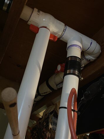

    kmikemoo over 1 year ago in reply to davebullockmbe
    davebullockmbe Laughing  I have something like that for turning the valves on my sump pump plumbing.  I will have to copy your tool. Thumbsup

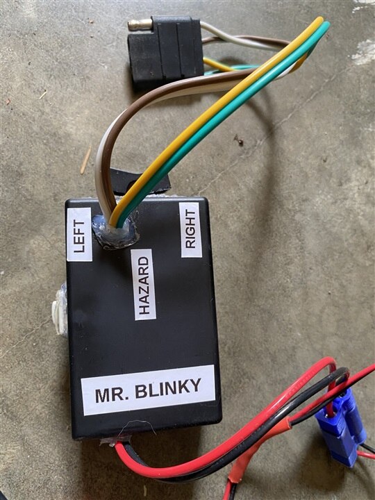

    I also like your mouse jiggler that you made, Doug.
    I’ve probably made some hacky little tools over the years but can’t remember most of them.
    Recently I made a tester for boat trailer wiring, that blinks the lights, and has a few switches to control which ones to blink, because the salt water keeps corroding various parts of it (the trailer wires, plugs, and lights) over time. It plugs into either a powerbox or lithium type jumpstarter pack.
    say hello to Mr. Blinky!
