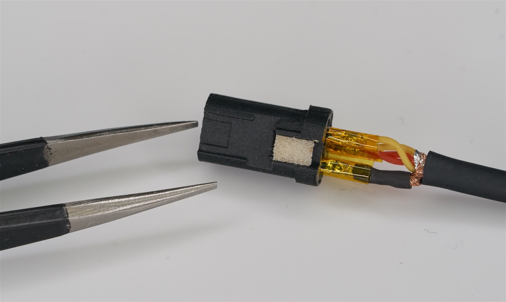

    dougw Oh, my favorite hatted thing to do in the shop! Before we can build a custom cable you have to take a long look at "TOOLING" Well if you are working with mill connectors, which I do, they come in…

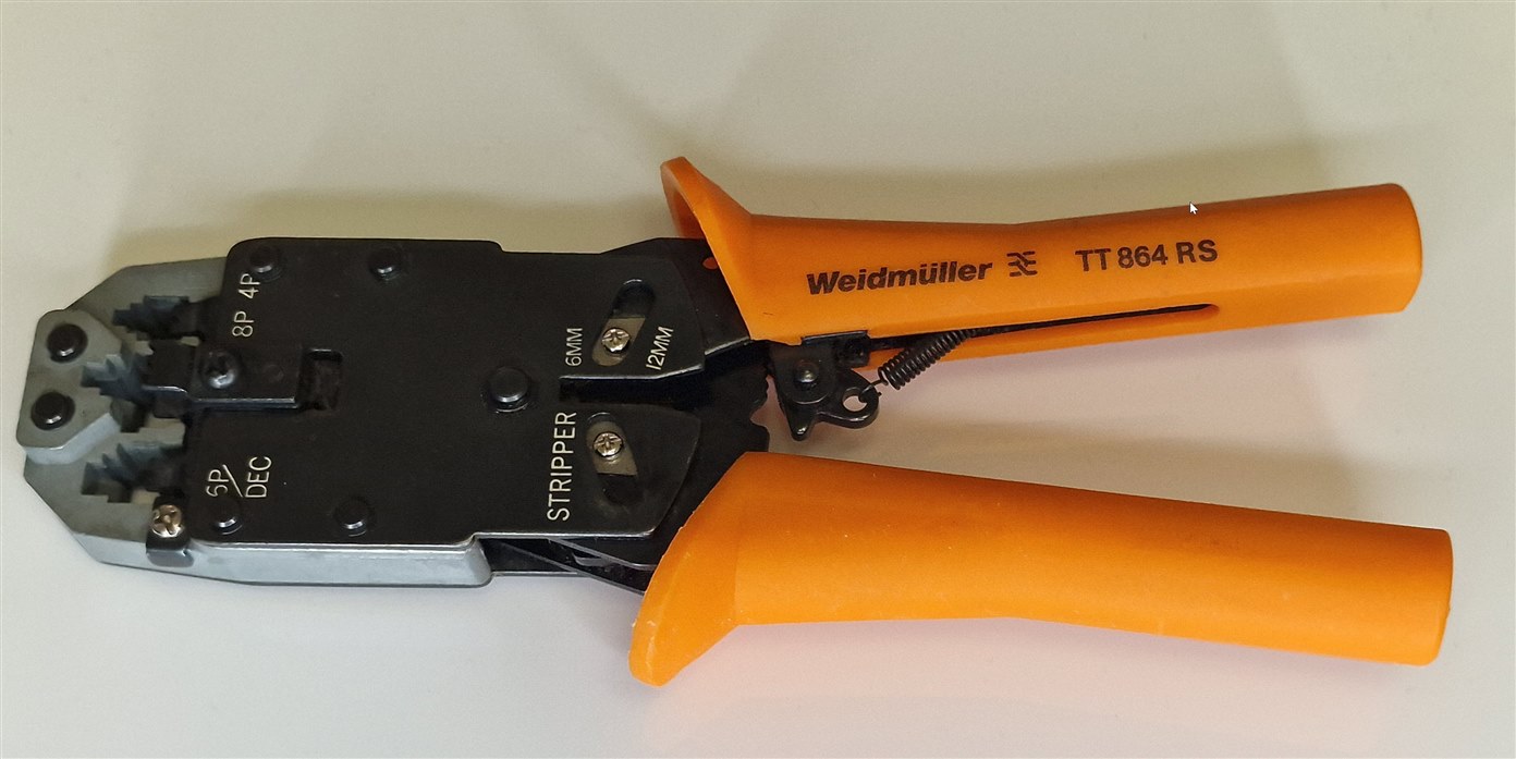

    They are excellent connectors + cable. Also one of the cheapest ways of obtaining prototyping wire at low cost, just strip off the outer jacket.
    Here I think the ready-made stranded wire patch cables cost a bit more than DIYing them (assuming the typical ratchet tool is available), but either way, they are low-cost. Solid-core wire plus the plastic tool is often used for the fixed wiring install. A bit naughty, but I like using RJ45 for non-Ethernet stuff too, as long as it is labeled clearly. Major benefit being that the patch cables are ready-made so no time wasted assembling cables.
    I also like circular connectors (since it's so easy to drill round holes for those!) but I don't have a favorite. Pity some of those connectors can be pricey, whereas RJ45 is super-low-cost.
    The tool I've used for > 10 years. It does 4 and 6-way connectors too, but I rarely use those.

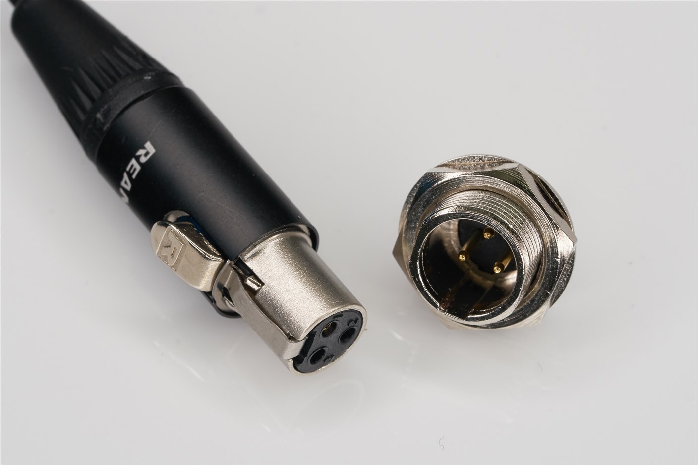

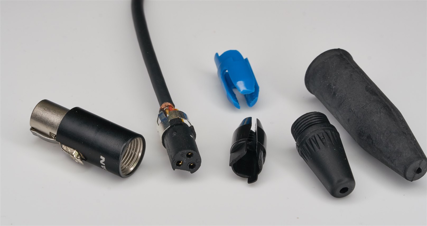

    I wish there was a source of good quality but low-cost pre-assembled audio cables. All the consumer stuff is low-quality, and all the studio grade cables are pricey.
    I end up DIY'ing them and it takes quite a while.
    Mini-XLR cable I had to assemble today.

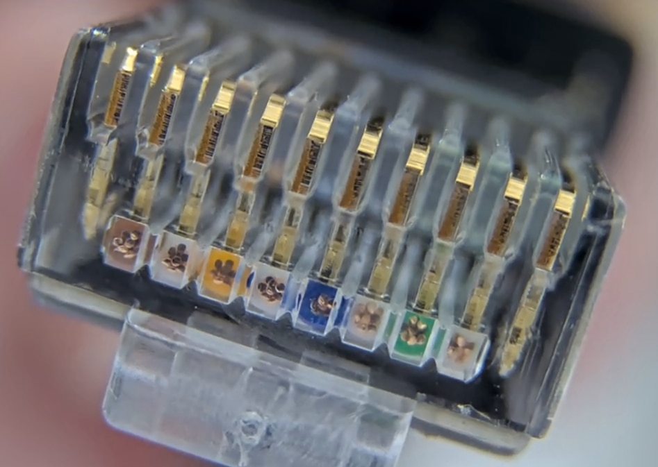

    (FYI the photo was taken with an Axis M1135 CCTV camera)
    Have you used any other connectors for Ethernet ?
    shabaz over 1 year ago in reply to beacon_dave
    I have hundreds of RJ45 connectors to use up first, but that's a good point, there are less common variants to  eliminate risk of accidentally plugging the wrong thing in.
    There's a small amount of precedent for non-Ethernet with RJ45, I think I saw some device with a very recessed RJ45, that needed a specially moulded cable shape to fit it. Also sometimes RJ45 is used for (ancient) telecoms protocols, e.g. some ISDN variants can use it I think, even with the same moulded latch position.
