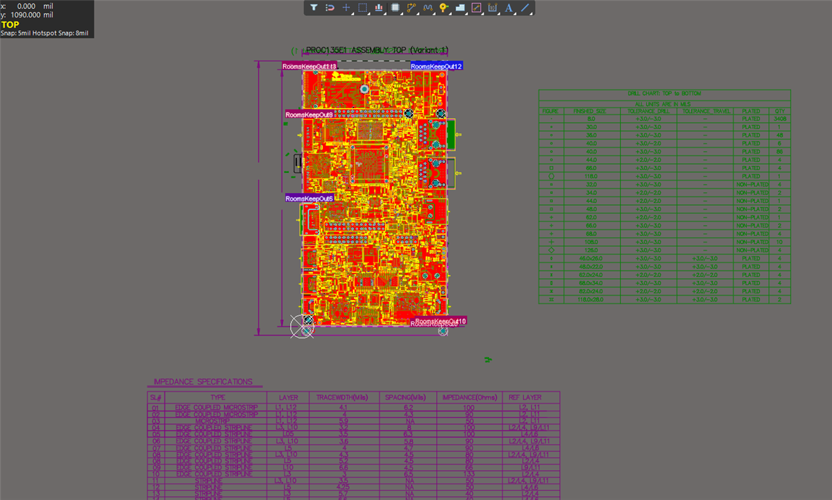

Hi everyone,
I recently came across the SK-AM62P-LP Evaluation board on TI.com. TI included the design files, and I thought analyzing them would be a great way to expand my knowledge of PCB design.
The project seems to have been designed using Allegro, and the provided file has an .alg extension. Since I don't have the software to open or convert this, could someone who has Altium Designer do me a huge favor?
I've attached the file. If anyone is kind enough to convert it into a .PcbDoc format and attach it in a reply, I would really appreciate it. Thanks in advance for the help!"
