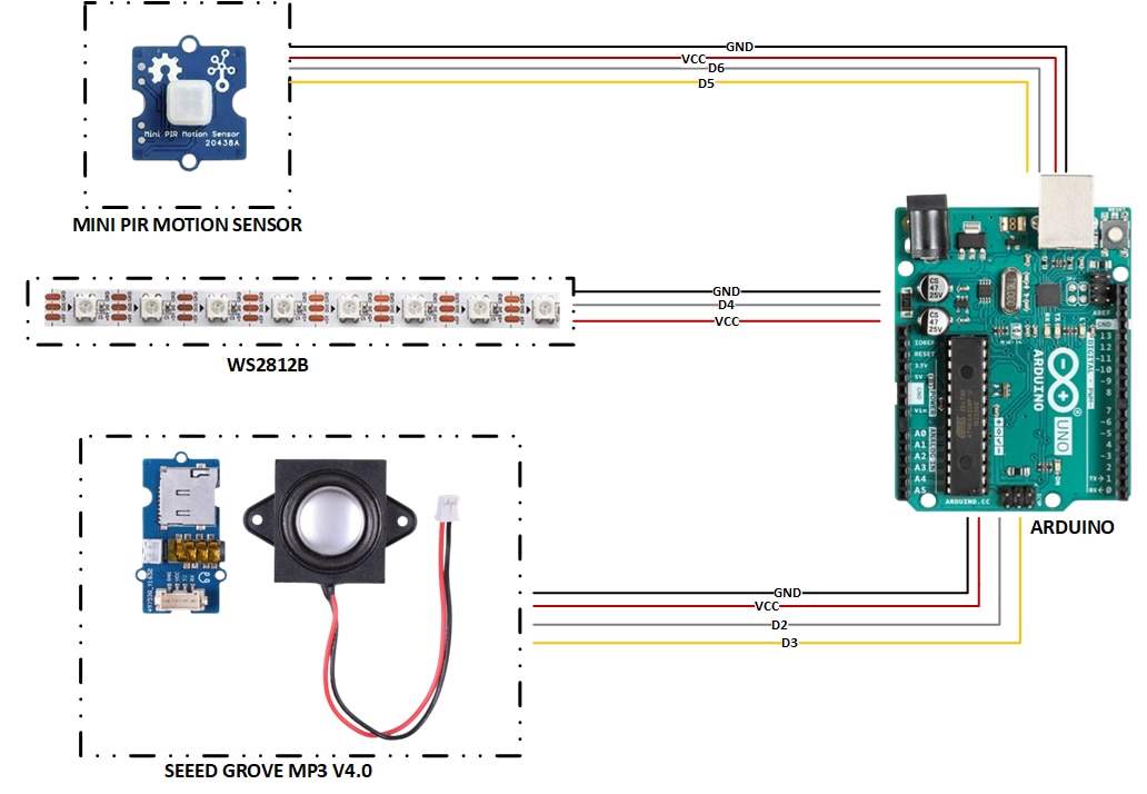

The hardware setup involves assembling the components onto the wreath frame. The PIR motion sensor is strategically placed to detect movement from a wide angle. The WS2812B LEDs are arranged around the frame to provide uniform and vibrant lighting. The Arduino Uno connects to the PIR sensor, LEDs, and MP3 player module through defined pins. The connection is as shown in the figure below
Since i am using the grove type sensor, i thought it would be easier to use the Arduino grove header. The image below show the actual connection.

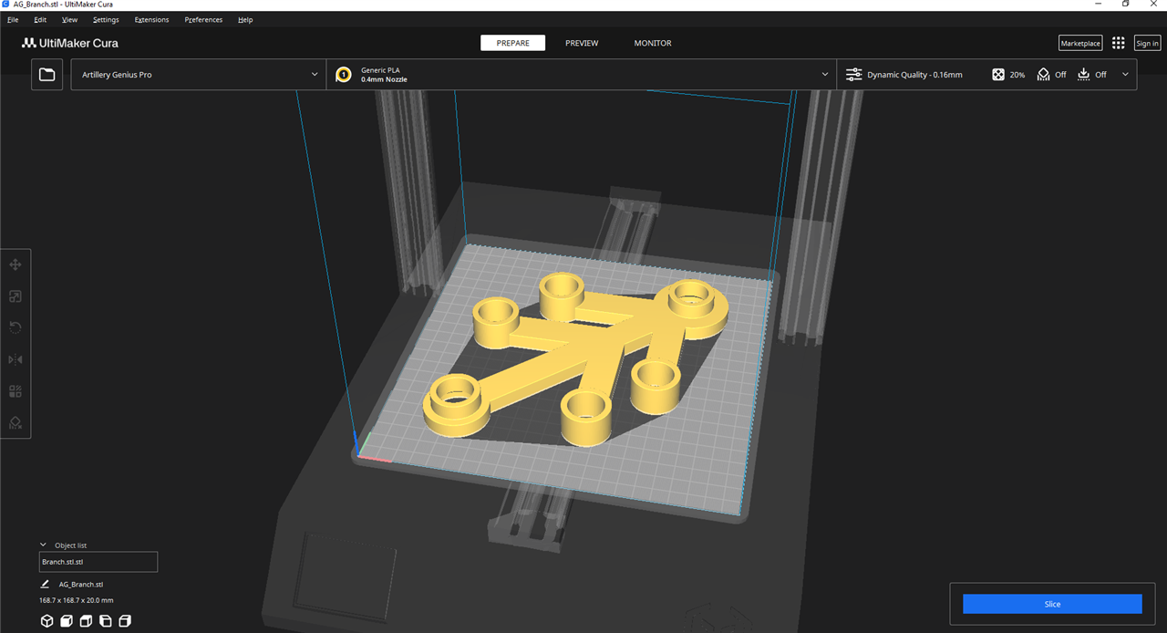

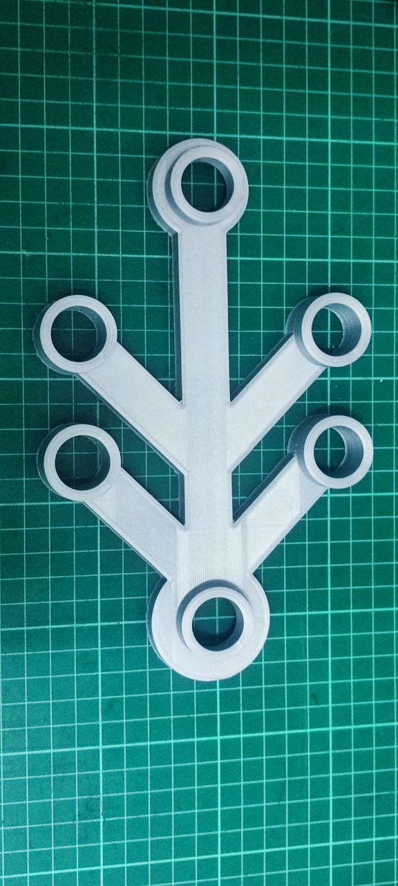

As for the base or the holder i have 3D printed it. The design is available online.
There are total of 6 unites needed to be print.
Once all are printed, can assemble it together and start to install other hardware as well. The image below shows the stages involved in building the hardware part
