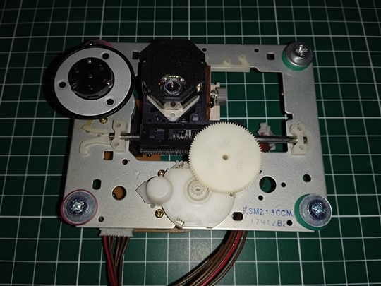

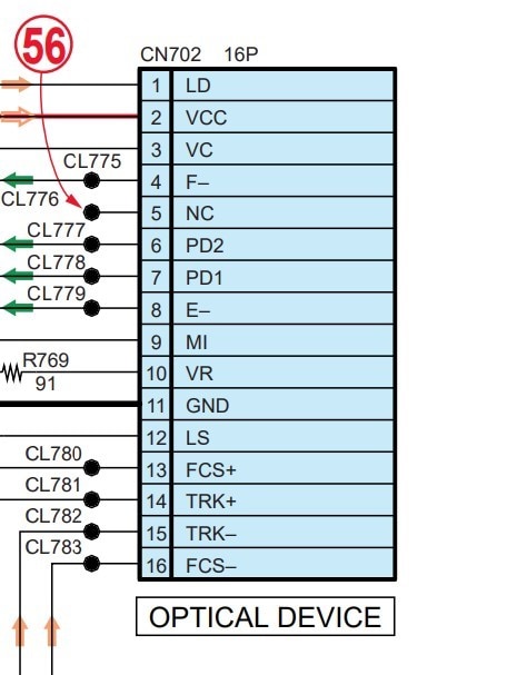

Having dug around the Internet in search of information on how to repair or what can replace the original CD-ROM from Playstation 1, I found out that for 25 years no one has created a full-fledged drive emulator that would fit all revisions of Playstation 1, but I came across photos in which someone was able to connect a CD-ROM from an audio player to Playstation 1, later I found the connection pinout. To replace the original CD-ROM Playstation 1, you can use CD drives from an audio player that use KSS 213C or KSS 213B laser heads.

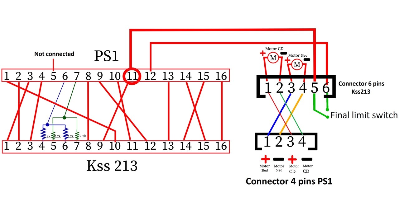

Here is a diagram of how the KSS 213C laser head should be connected to the Playstation 1.
On the left is the pinout diagram of the KSS 213C and on the right is the Playstation 1 connector.

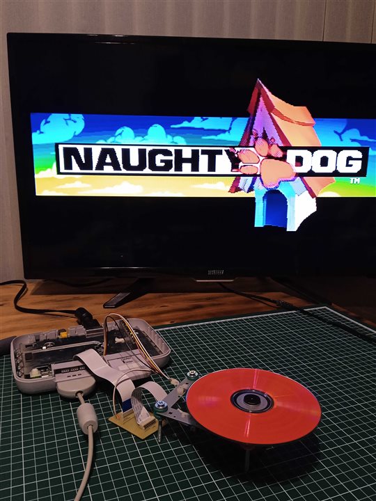

I quickly made a diagram in KiCad, the diagram is simple, it uses only four 2.2k resistors.
Made the board using a laser printer and etching.

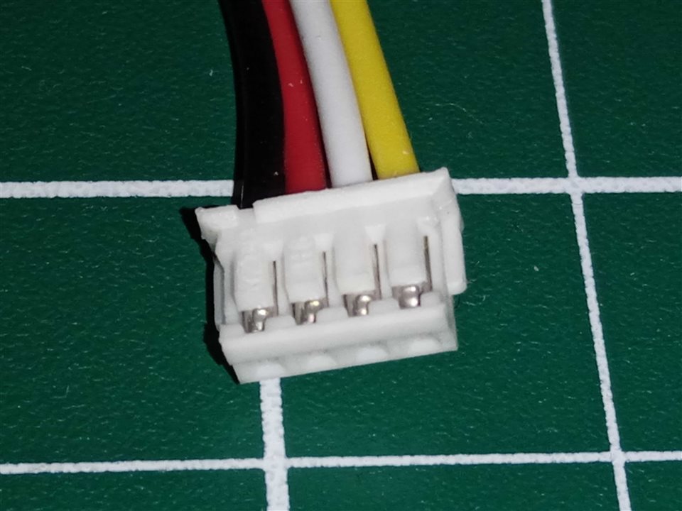

The ZH1.5, 4P connector is very suitable for the CD-ROM power connector in the Playstation 1.
I found an old audio CD player at home and took out the drive from it.

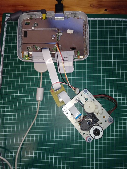

Assembled and connected everything.
And here it is, the long-awaited switch-on.
A few seconds of waiting and the familiar splash screen finally appeared on the screen. It was the same sound I heard as a child, and which seemed to be lost forever. The whole repair process was like returning to the past, when every moment with the game was something special. My old console works again, and with it a piece of that time that is so dear to me returned. And I realized: sometimes, to feel alive, it is enough to simply return to where it all began.
