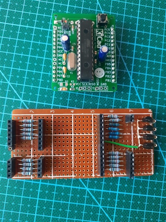

For all these LEDs to be more delightful we need an intelligent control (and the human eye which is easy to fool Joy), the microcontroller I use is an ATMega328P mounted on a minimal PCB that I atached to test board. I had to solder some more components and the conclusion I came to was to use pin headers. Maybe I could have used only the minimal PCB but it only resulted in an unwanted crowding of wires and solders.
I used almost all available GPIOs, as you can see in the pictures. I placed a 220Ω resistor on each GPIO that is connected to the LEDs anodes and the BJT transistors have their collectors connected to the cathodes, one for each layer.
I thought I'd build a PCB for this cube to be more stable, rather than soldering LEDs on a wire, and maybe even positioning them crookedly. So, a simple PCB just for LEDs, precisely cut, dimensions ~65x65mm. We have 16 LEDs on each layer, grouped in 4. The cathodes are interconnected vertically, 4 on each layer.

Since I made a PCB for the LEDs, another minimal one for the microcontroller, the rest of the resistors and transistors components can be assembled on a test PCB. So I proceeded to a "low cost" PCB, let's say. Sweat smile
This is where the headache starts. Unfortunately, I didn't analyze this project in detail and I missed some aspects. The first would be that the copper wire I use is 1mm in diameter. The holes drilled in the PCB are about the same size, but in the end they fit. Another thing was that the copper wire has a protective outer layer of enamel (or something like that) that is quite difficult to remove but I handled it somwhow. Even so, at some point it was difficult to make correct soldering. I found a coil and cut a few segments with pliers, then removed the outer enamel little by little. One thing I try to apply as often as I can, modular assembly, I first thought about the PCB with LEDs because it is a little difficult to troubleshoot if problems arise, but at least I managed with the 20 wires soldered to the rods, I used female headers.
The layers are spaced ~20mm apart, which is enough for 5mm LEDs.
Tips for anyone who wants to do such a project: use a wire or rod that can be soldered along its entire length (without protective outer layer), it saves you a lot of manual work; position the 4 layers (PCBs) then insert all the wires through the interconnection holes. Later, you can easily space them out as you wish.
I used a single power supply, 5V, for which I had to solder the wires and the DC jack.
