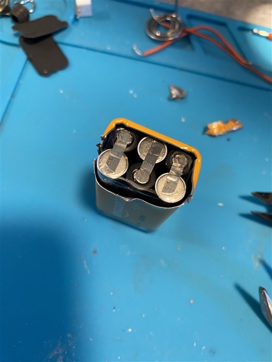

Every time I replace the 9v battery in my smoke detectors, I end up with 3 more slightly-used but still somewhat usable batteries. It seems wasteful to just recycle them, and I don't really have anything else that can use them.

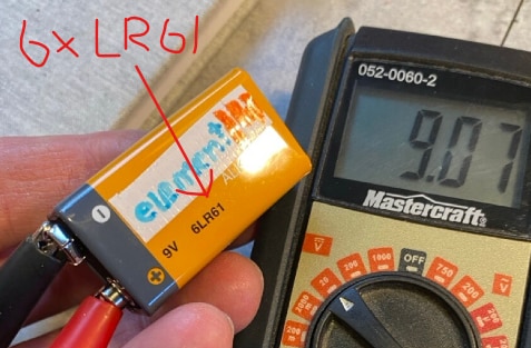

For example, this used battery still has over 9v - I think that means it's still about 70% full? 9.6v is new.
9v battery used

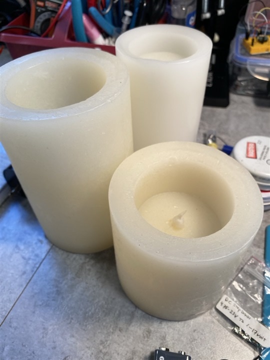

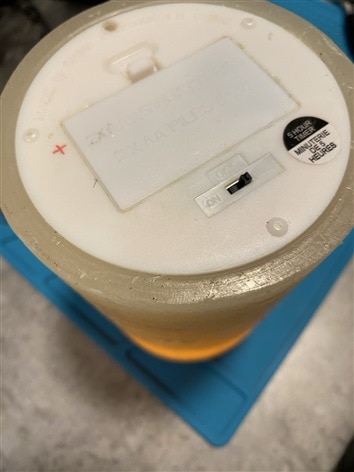

I had 3 candles that were already in rough shape, so I could do some experimenting without upsetting others in the household who might not want me breaking their stuff. And I still had a couple of DC-DC step-down modules I've been curious to try. I also still had several 9v connectors I had salvaged over time from old electronics.
3 candles9v with step-down conversion

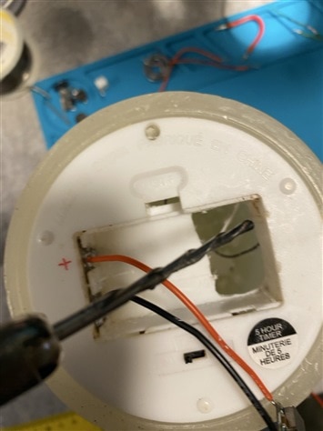

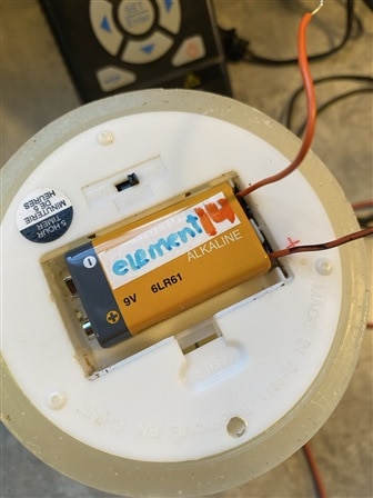

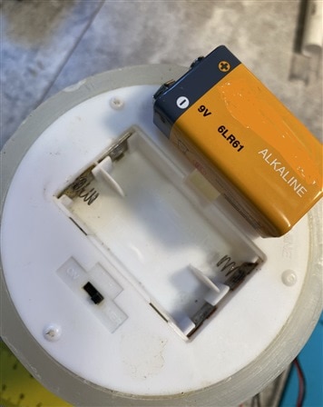

The size of the 9v battery looks promising, compared to the 2AA compartment. So I cut out the plastic bits, removed the rusty joining plate at the one end, and added testing wires to the connections.
9v vs 2AA9v in 2AA compartment

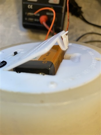

But alas... it looks like the 9v battery is slightly too thick!
9v thicker than AA
So I pulled out my chainsaw! and put it to the side so I could get to the small battery operated little rotary tool behind it.
It's a bit hard to see, but I just added a hole to allow most of the 9v battery to be pushed up into the hollow area inside of the candle - there's LOTS of space in there. Careful with the wires though.
That worked, and also allows for plenty of space for the conversion module. I did have to use different wires on the module - the original was not flexible enough to put up with the bendy-squishy fitment.
cutting a hole for a 9v batteryfinal fit with 9v and modulelid closed over 9v battery with module
