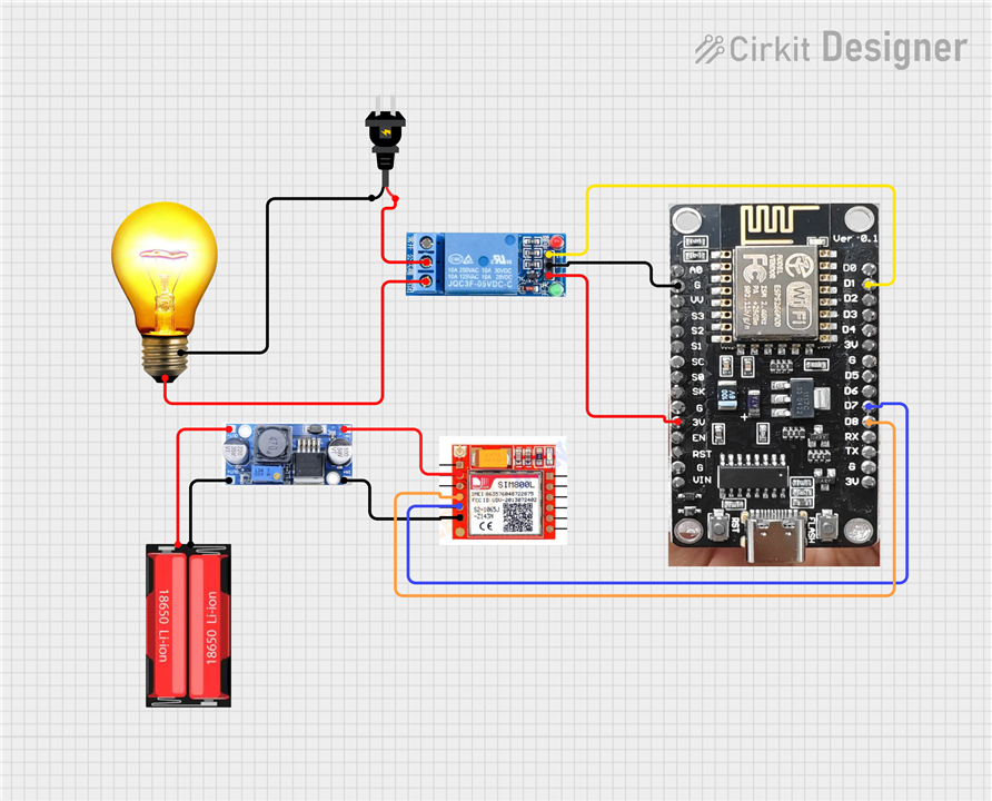

Following are the components used:
1. GSM Module (SIM800L): Receives phone calls or SMS. Communicates using AT commands.
2. Node MCU (ESP 8266): Microcontroller, processes GSM signals coming via TX/RX and controls relay operation.
3. Relay Module: Electrically isolates low-voltage control circuit from AC lights. Switches Christmas lights safely.
4. Buck Converter (LM2596): Steps down DC to 4.4v required for SIM800L to work properly.
5. Electrolytic Capacitor (1000µF, 25v): To handle current peak during transmission by SIM800L module.
6. 2 18650 Li Ion Batteries
7. Breadboard and Jumper wires
Circuit Connections:
SIM800L TX → NodeMCU D7 (GPIO13)
SIM800L RX → NodeMCU D8 (GPIO15)
GND → Common Ground
VCC → Buck Converter output(set to 4 to 4.4v)
Relay IN → D1
Relay VCC → 5V
Relay GND → GND
GSM modules draw sudden current bursts, which can reset or malfunction the system. So we will add a 1000µF near Vcc and Gnd of GSM module.
Working:
  • User makes a phone call or sends an SMS( depending on our programming)
  • GSM module detects the incoming command
  • GSM sends response data to the microcontroller via UART
  • Microcontroller reads and processes the command
  • Relay is switched ON or OFF
  • Christmas lights turn ON or OFF accordingly
