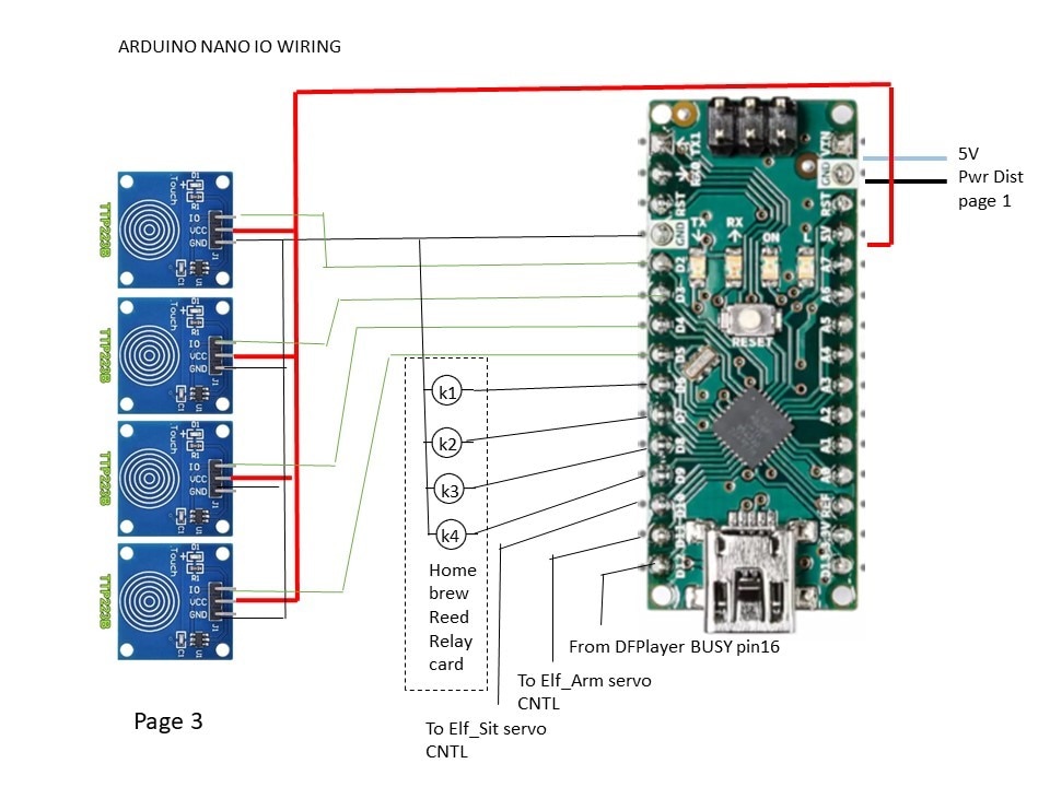

photos, schematic, code , and text included below

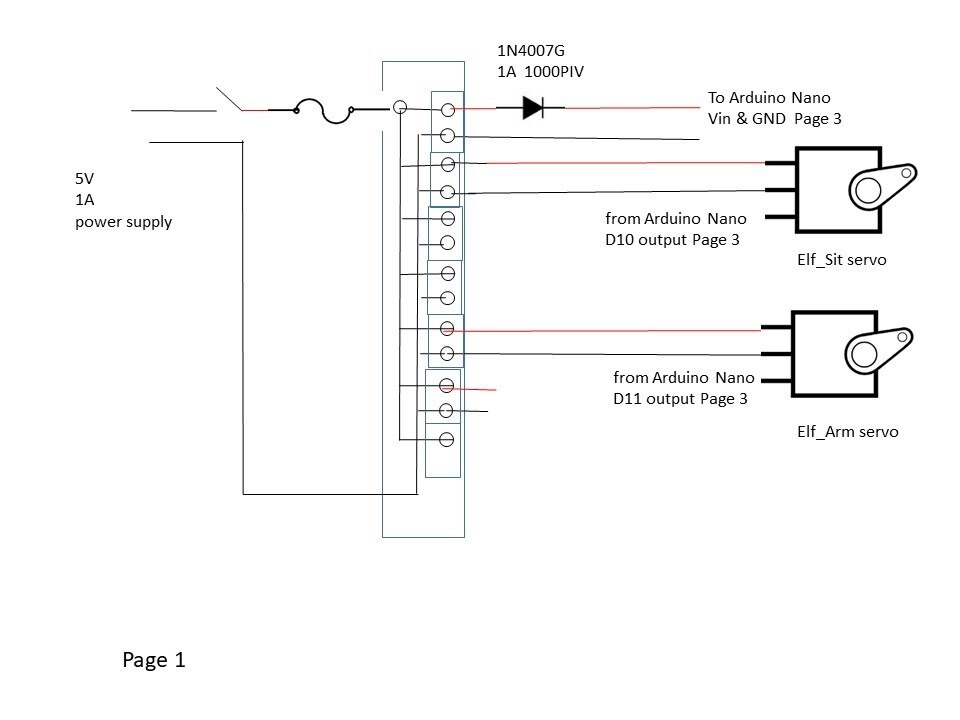

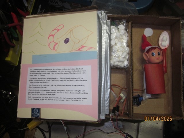

After assembly and testing, the micro server on the Elf “sit up” chair didn’t have enough torque. Bumping up rail voltage would make the project add another buck-boost power supply just for the DFPlayer. I tried a larger servo, but it too needed more voltage. I had to disembody the elf and mount his head on a toilet paper roll body to reduce weight.
Finally, perseverance paid off, the project got into working shape bit by bit. I’m satisfied with it as a working prototype.

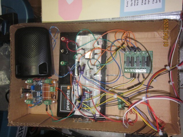

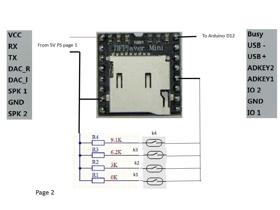

The control electronics took up a lot more room than I expected. I ran out of Arduino Nano terminal boards, and materials to build custom boards. The DFPlayer serial communications were uncooperative, had to switch to analog, which made me order parts to build a custom Reed Relay interface card.

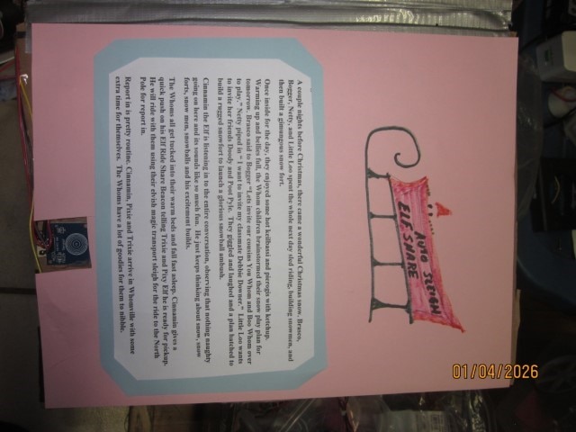

cover and page 1
top view of cover/page 1
top view page 2 & 3
         page 2
page 3
page 4 and animatronic sit up elf with marshmallow launcher arm
bottom box:  buck power supply 12V to 5V.   Arduino Nano and DFplayer on E14 protoboard (never have enough of those)
Arduino 5V power distribution card for TP223B capacitive touch switches, homebrew reed relay card to interface DFPlayer
