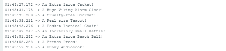

There’s (currently) 150 base gift items that get combined with 20 themes, 50 styles and 20 sizes to generate around 1 million combinations. Now, not all items will get a size, or a style or a theme. As previously hinted, for every item, there’s 3 numbers between 0 and 100 that determine how likely that item is to be accompanied by each of the attributes. An item with a 0% chance of having a theme will never have one. An item with a non-zero, but <100% chance of having a size may or may not get one, etc, which gives it a lot of flexibility and makes the suggestions a bit more coherent and varied.
Upon startup the system also computes how many combinations there are with the current list of items and the attributes each one of them can have, so if you change the lists or alter the probabilities, you should get an updated number in the USB console when the system boots.
A note regarding combinations: While you may think that “A real size horse”, “An average size horse” and “A Horse” are all the same suggestion, I politely digress
Some suggestions generated by the system:
What is a Pocket Tactical Chair you ask? Great question.
By the way, as you might have noticed, I also implemented a very rudimentary system to make sure that it would select "A" or "An" appropriately, depending on the word that comes after. While some gift ideas might not make sense, I put some effort into making them at least grammatically sensible.

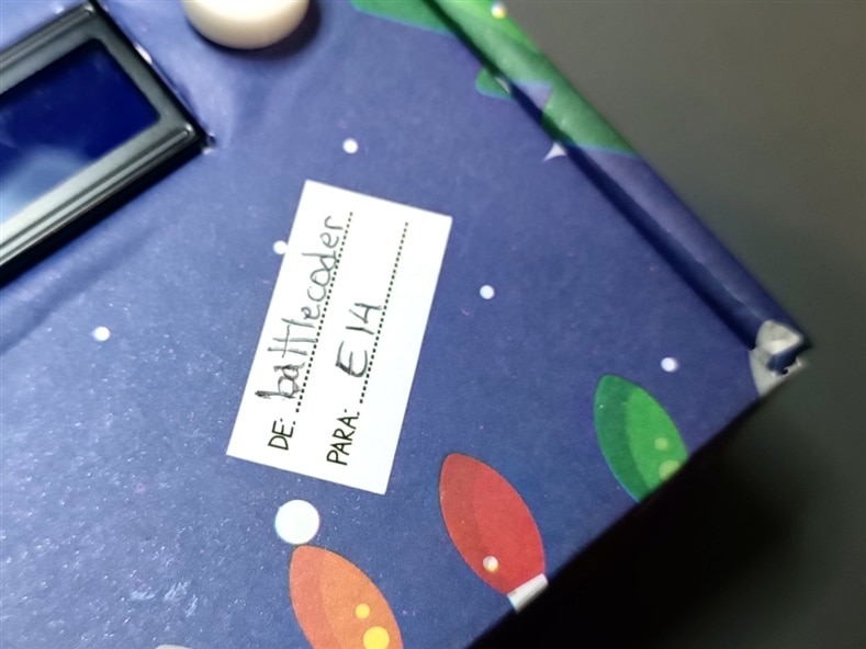

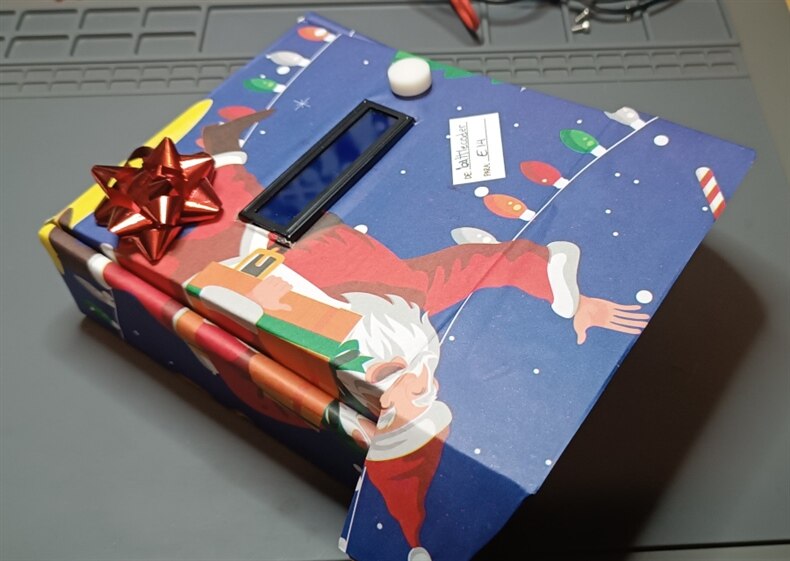

After I was happy with how it was working I soldered cables from the RPI Pico to the LCD and to the button, and mounted them inside a cardboard box that I gift-wrapped to the best of my abilities (I really tried but it's a bit of a mess) and added a 3D printed button cap on top of the push button.
I'm not going to show you the inside of the box because the mess of cables is hideous, and I still haven't fully solved how to make an easy access to the battery pack inside. You have to open the box to change the batteries or turn it off, but luckily that can done very easily, as the box has a sort of lid.
Result
Without further ado, here's a video of the Gift-O-Tron in action!
A note here, the message it prints before giving you a suggestion is absolutely just for flavor. The Gift-O-Tron generates suggestions in a fraction of a second, but I think the pause adds suspense and makes it more dramatic.
