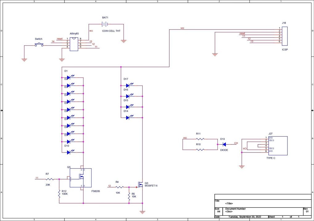

Next, I prepared a simple Schematic with other Attiny13A MCU that had two Mosfet as Switch setup, One Mosfetr that only had 4 LEDs connected in series was the AO3401 N channel mosfet which can handle 4A of current at 30V max.
5V will be used here if powered by the USB port and 3V if powered by the Coin cell.
For 10 LEDs, the same mosfet as switch setup was utilized but with the 8205A Mosfet IC that has two mosfet on it, I connected both in parallel so it can handle a total of 12A, and 6A each at 20V which is too much for this system but keep this in mind, always choose components with at least double the current usage of your project requirement.

As for the current limiting Resistor and Diode of the USB Type C Port, both are placed on the bottom side of the board because of space issues.
ISP Connector is an SMD Con6 Port that is made especially for using a POGO Pin setup for flashing this board.
