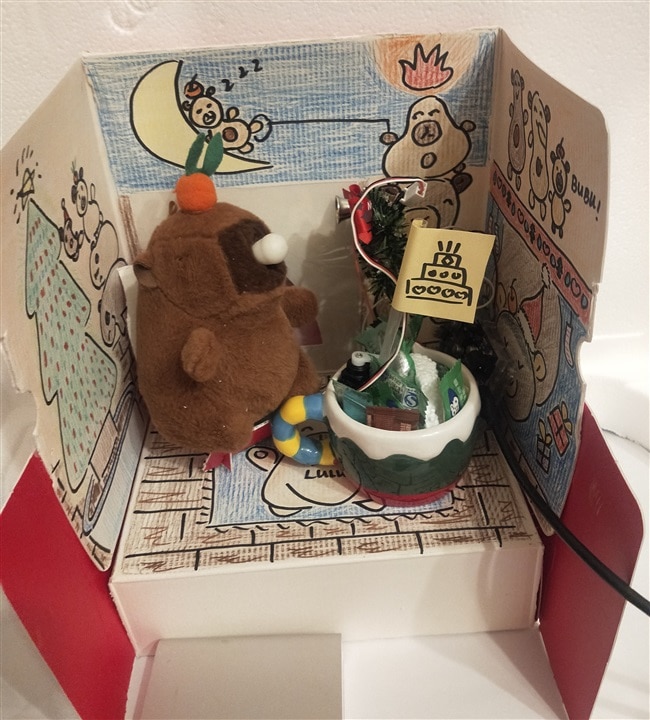

To pair this cozy capybara diorama with Arduino magic: This is a Capybara Christmas Micro-Diorama—Arduino powers twinkling LEDs on the tiny tree, a servo that wiggles the capybara’s carrot-topped head with a cake flag, and a buzzer that plays soft carols.
The kit (behind the mug) hides the microcontroller, wires, and battery, blending tech with hand-drawn charm for a whimsical holiday display.

First, prepare the story and draw on the dome of Capybara, here is the story.
On Christmas Eve, LuLu the capybara fussed over his cardboard diorama: a tiny potted tree, a hand-drawn moon, and a paper cake (topped with a flag) perched in a mug.
Then LuLu spotted the Arduino kit tucked in the mug. With clumsy, fuzzy paws, he wired a servo to the cake’s flag, and a buzzer to the tree’s base. When he prodded the switch, the Arduino hummed to life: the servo twitched, making the cake flag wave like a tiny holiday banner, and the buzzer trilled Merry Christmas in soft, warbling notes.
The ink-drawn capybaras on the box walls seemed to lean in, their sketchy smiles widening. A crumb (from LuLu's reed snack) landed on the cake— the servo jiggled the flag.
By midnight, the diorama glowed: the tree’s LEDs (wired to the Arduino) flickered, the flag waved, and the buzzer’s tune lured a curious ladybug to crawl on the mug. LuLu curled up, the servo’s quiet tick-tick mixing with the ladybug’s buzz. Christmas, he decided, was just this: flags, carols, and a tiny microcontroller turning a cardboard box into a party.

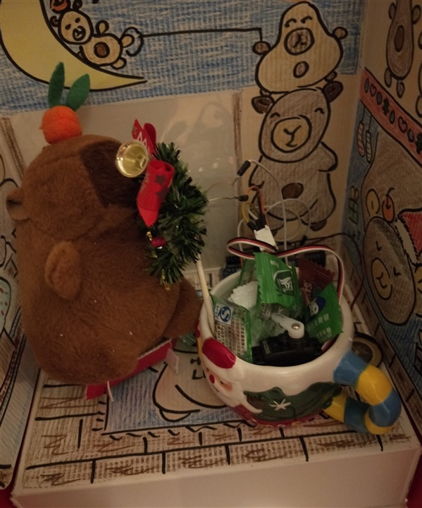

3 Hardware and wiring
3.1 LED (D12)
LED long pin (+ / anode) → Arduino D12 pin
LED short pin (- / cathode) → Arduino GND pin
better add a 220Ω current-limiting resistor in series (protect LED from burnout)
3.2 Servo Motor (D6)
Standard 3-wire servo (SG90 recommended, 9g micro servo):
Brown wire (GND) → Arduino GND
Red wire (VCC/5V) → Arduino 5V pin
Orange/Yellow wire (Signal) → Arduino D6 pin (PWM pin)
3.3 Active Buzzer (D4)
Buzzer + pin → Arduino D4 pin
Buzzer - pin → Arduino GND pin
3.4 Arduino zero board

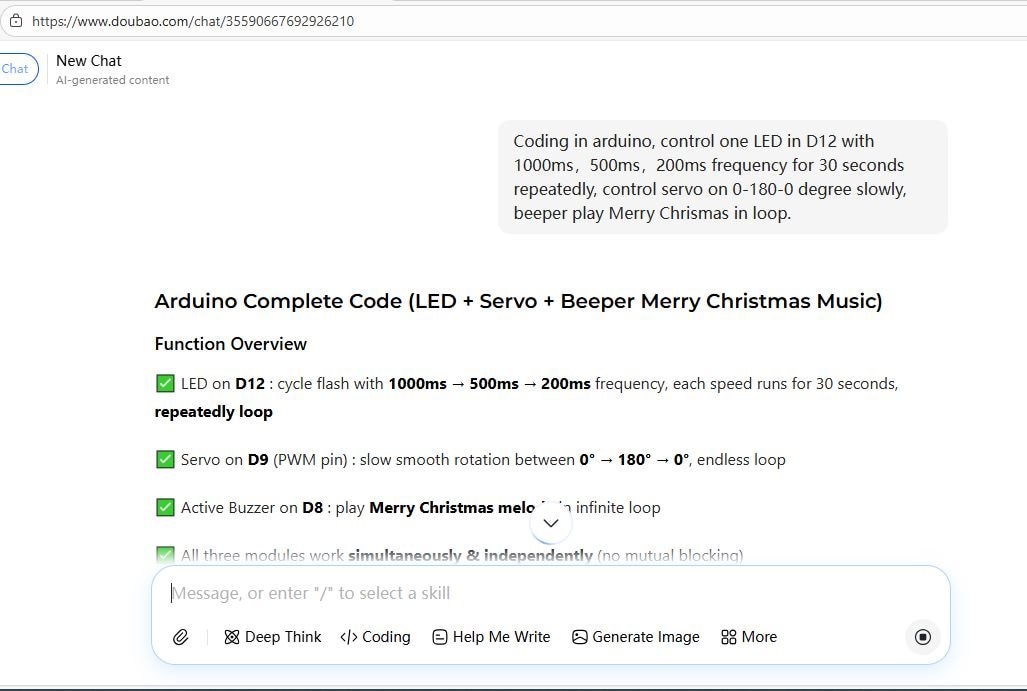

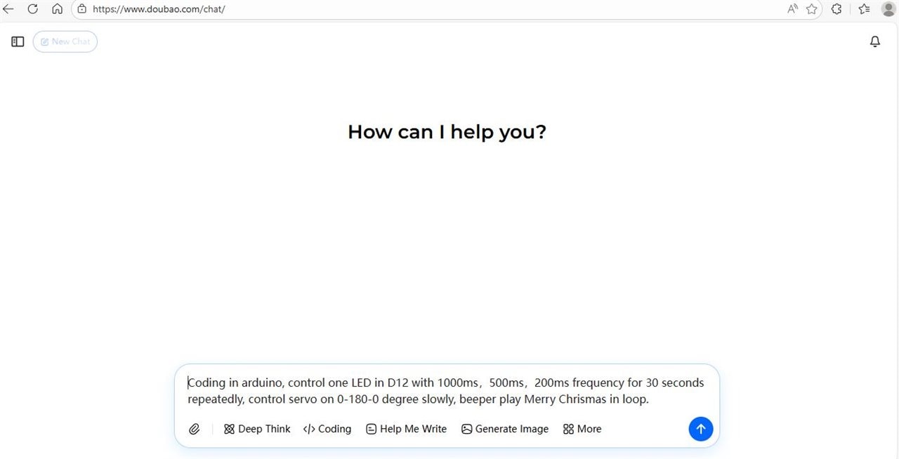

I prepare what I want as
Coding in arduino, control one LED in D12 with 1000ms,500ms,200ms frequency for 30 seconds repeatedly, control servo on 0-180-0 degree slowly, beeper play Merry Chrismas in loop.
Then the screen pop up paragraph by paragraph, explain how the LLaM understand my prompt step by step and bring about arduino code.

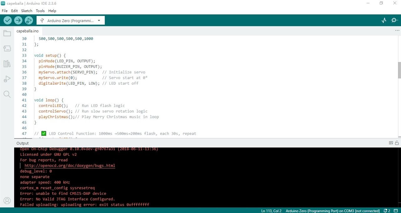

4.3 Paste the code in Arduino IDE and compile and upload
Copy the full code to Arduino IDE
Select your Arduino Zero board and correct COM port (COM3 in this case)
Upload the code
Connect all hardware according to the wiring guide
Power the Arduino → All functions work immediately!
Yes, indeed, now errors

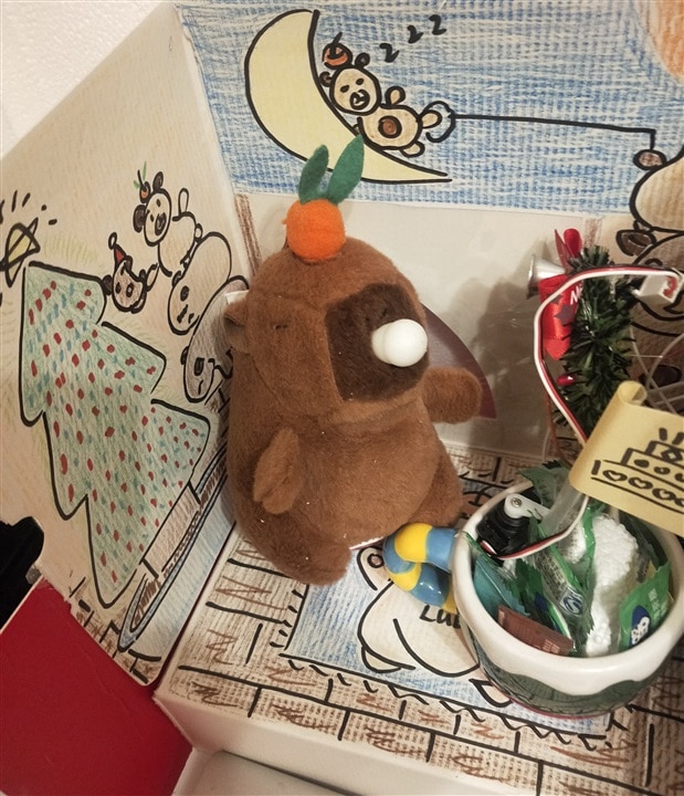

5.1 Here is where Capybara lives,
5.2 Capybara play at daytime and night happily
