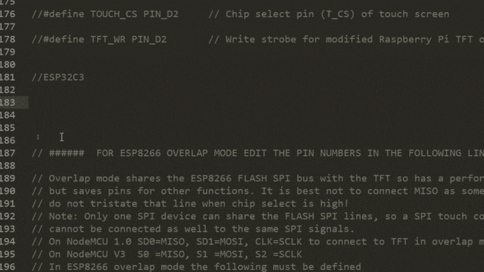

Before uploading the code, the Arduino IDE should have a supported library. The TFT_espi is the best library for displays; it can run almost all types of displays, even e-paper displays.
I am a fan of this library; check out my old project based on it (the uncanny eye pendant).
To download this library go in sketch >> include library >> manage libraries, here search for TFT_espi by bodmer.
Also need to download WiFiManager by tzapu and ESP32Time by fbiego.
After downloading the library there need to do some changes in TFT library to get library work. For this, go to My PC.
My PC >> Documents >> Arduino >> Library >> TFT_espi
Here there is User_setup File Open the file comment the driver in 45 line, and uncomment driver in 65 line, which is "#define GC9A01_DRIVER" .
Now comment out "pin" defined in lines 169, 170, and 171 and add the pin definition given below.
#define TFT_MOSI 6
#define TFT_SCLK 4
#define TFT_CS 7
#define TFT_DC 1
#define TFT_RST 5
