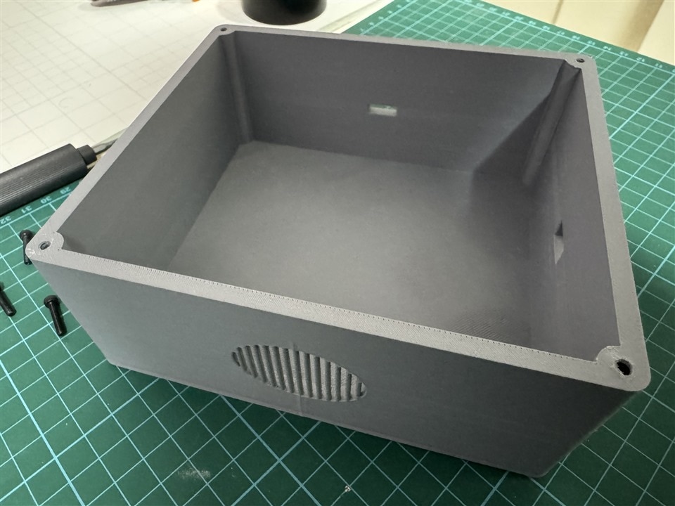

3D Design & Models
The enclosure was designed to make the project feel like a finished “device” instead of an exposed electronics prototype. The main goals were to keep the TFT easy to view, route the LED strip cleanly, hide wiring, and still allow quick access for debugging and maintenance. The casing is assembled using four M3 × 16 mm hex button head cap screws, which keeps everything sturdy while remaining easy to open.
I designed the parts in Fusion 360 and printed them on a Bambu Lab A1 Mini using PLA Basic and PLA Matte. The design is intended to be straightforward to print and assemble, while providing enough internal space for the perfboard electronics, wiring, and speaker. Since the LED strip can be mounted onto almost any structure, the models can also be remixed into different “gate” shapes—taller arches, wider frames, wall-mounted portals, or tabletop mini-gates—without changing the core logic of the project.
