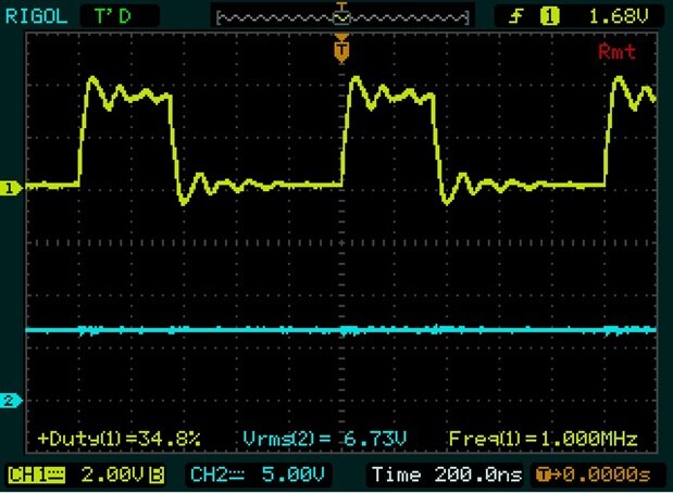

  • An optional oscilloscope to look at the signal going into the LMG5200. We'll be working at 1 MHz.
    The scope is not neccesary, but it will enable you to see and measure the attributes of that input signal (frequency, duty cycle).

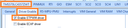

Firmware and Module Setup
Each module requires some setup. Activation and configuration of peripherals is done in Hercules HALCoGen.

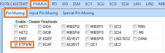

Quadrature information is decoded with the eQEP module. We're using eQEP instance #2 because that is broken out to connector J10.
At least EQEP2 Pin A and B need to be enabled.

PWM
For pulse width modulation , the Hercules family has ePWM modules.
At least PWM1 A needs to be enabled. Don't forget to check the Special Muxing settings.

Results
The system will start up with the lamp fully dimmed. You can control the brightness by rotating the encoder.
Use the current meter to check the current coming from the power supply, and the current going to the lamp.
Check how it changes when rotating the scroll wheel.
Attach the voltmeter and check how the output voltage changes.
Attach your scope to the PWM signal. If you have a math function, you can see the duty cycle change and the frequency staying stable.
