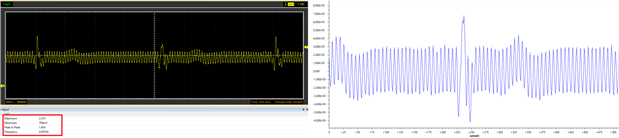

Input signal:
Signal sampled by the ADC (Hercules RM57x)

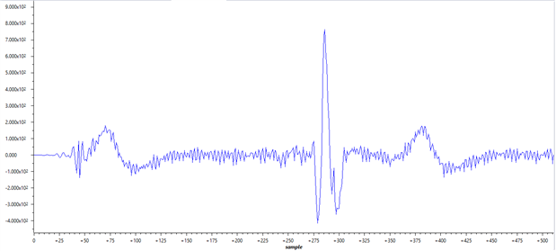

Filtered signal
The heart signal was properly filtered, you can clearly notice the PQRST wave

    BTW: A second sample of the cardiac signal
    Input Signal
    Filtered signal
