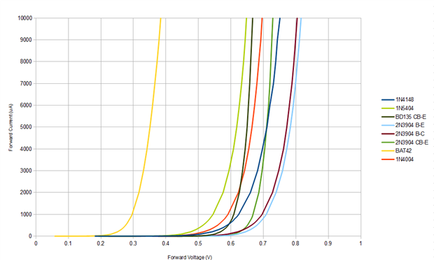

The following graph shows the B-C B-E and CB-E forms for a  2N37042N3704 CB-E for a BD135(a medium power device intended for audio amplifiers
along with a few common diodes. I've also included a small-signal Schottky diode (BAT42) for comparison. This plot is in the usual form.

All the curves are different. What I am measuring evidently isn't just a simple piece of semiconductor physics, though all the curves have a similar
form with a straight section at the lower currents and moving away from that higher up. I'm not going to sample lots of devices, but be aware that
there will be differences between different batches from the same manufacturer and differences between parts marked with the same part number
from different manufacturers.
The two CB-E transistor curves stand out as being almost straight lines over the five decades of current I've done the measurements for. In practice
the relationship holds much further and it points to one of the main uses of transistors in this configuration - linear to log and log to linear conversion,
often in conjunction with an op-amp.

    The curve differences are probably due to the different level of doping in the semiconductor matrices.
    Each device uses a different combination depending upon the application.
    I do like your confirmation on the transistor curve of linear use.  Might be handy to exploit this capability one day.
