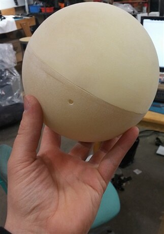

  • Catwell
    Catwell over 11 years ago
    Calculating the volume of a sphere...
