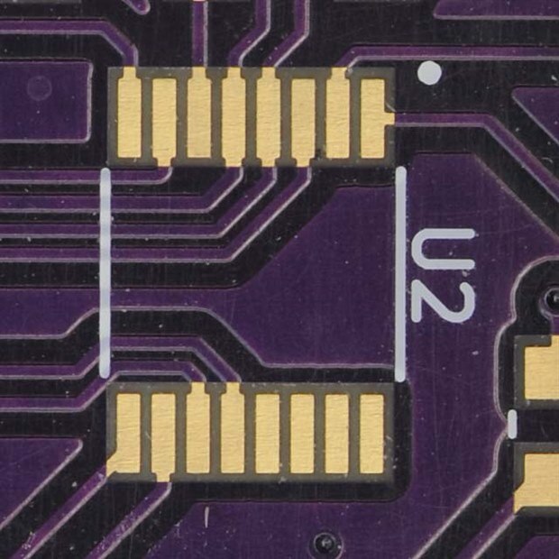

Now that the TI-RSLK robot RoadTest is finished I have turned my attention back to a problem spotted in the last round of PCBs ordered for the AIS alarm project.  But first, I have a new toy.
I have been looking for the right used Nikon microscope in budget but finally could not stand it any longer and bought this Chinese model after my friend bought one.  I am amazed at how much better this is than peering through a magnifying glass or loupe.  At low magnification stereoscopic details pops and there is good depth of field.  I bought a version that takes a C-mount camera but don't have a camera yet.  Good value for the money I think but this was a "want" rather than "need" purchase.

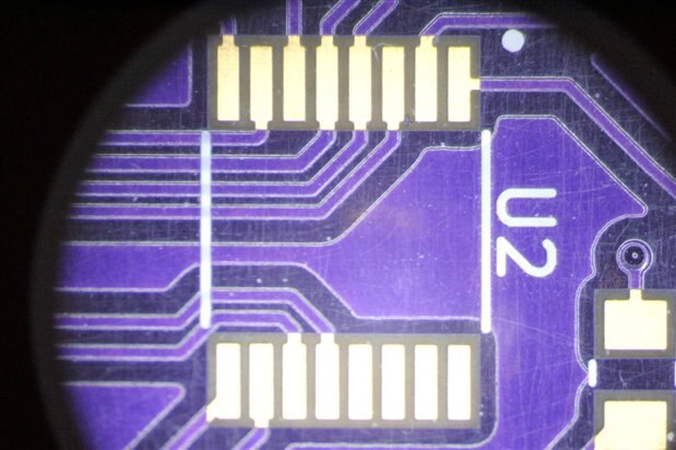

I went back and put some of my old PCB designs under the microscope and discovered several had a problem I reported in a previous blog - that is, the solder mask did not extend between the pins of smaller SMD packages.  This of course makes solder bridging and the resultant need for rework more likely.
I have had the problem occur for two reasons:
  1. The PCB manufactures had a minimum guaranteed spacing specification between the pad and the solder mask.  Check the specification especially with low cost prototyping services.
  2. I use KiCad and the default pad mask clearance is pretty high - so high that there is no mask between some SMD pins.  For KiCad the fix is to go into Dimensions -> Pad Mask Clearance while in pcbnew and change the default to the desired value.  OSHPark has a discussion on the topic and recommends 2 mil (0.05 mm) clearance for 2 layer boards.
The MSP430FR2xxx protoboard I put together a while back had the second problem and I did not realize it until I looked under the microscope.  They were made by OSH Park and it is hard to see the problem with the naked eye on that purple background.  Pesky default values....  I have reordered the board with the fix since they are inexpensive and I have another project in mind for that particular microcontroller.

    Hi Frank, That looks like a nice piece of equipment : ) 2mil sound good, or maybe a tiny bit higher may be preferable if you also plan to use prototyping services in China. If you look at the fourth photo…

    OK. It seems it's one of those contentious issues. From what I found things generally seem to come down on the side of having solder mask between the pins. I'm happy to have learnt something today. image
  • Fred27
    Fred27 over 8 years ago
    Getting back to your original question, I think it's normal not to try putting soldermask between SMD pins of such a small pitch. That board looks fairly normal to me.
    I can't remember where I read it, but I'm fairly sure the recommendation is not to try mask between the pins as it tends to flake off. Any misalignment may also mean you could get soldermask on the pads. (I'm thinking of 0.5mm or 0.4mm pitch LQFP and QFN packages here)
    I'm now going to go search and see if I can find more info. If anyone else beats me to it feel free to correct me.

    I have a T mount that I use on my telescope that fits Nikon cameras.  It doesn't fit the microscope but I found a way to hold it in place.  Among the many issues with this approach is it lacks the wide angle optics to get the full microscope barrel in view.  This photo was taken with a full frame Nikon DSLR.  I had to crank the ISO up to 6400 to get decent shutter speed and did not get the exposure correct but it gives the idea of what is possible with this approach:
    For comparison I took a quick photo with a 105 mm macro Nikkor (that lens alone is more expensive than the microscope with all accessories) on the same camera body.  It will focus down to 1:1 magnification but I was not that close and I have cropped it severely to show roughly the same area.  This was in indirect sunlight, the photo above was lighted with the microscopes LED illumination.
    Neither looks as good as the microscope viewed with the eye.  Since the camera has a HDMI port I could connect it directly to a monitor.  I think my friend's camera is the newest AmScope USB-2 and I hope to get a look at it.  But right now I am leaning towards the AmScope C-Mount Nikon adapter which costs about $100.
    PS:  The photos above are not an apples to apples comparison.  It just shows some of the issues with trying to hack a camera onto the 3rd port of the microscope without using proper optics.
