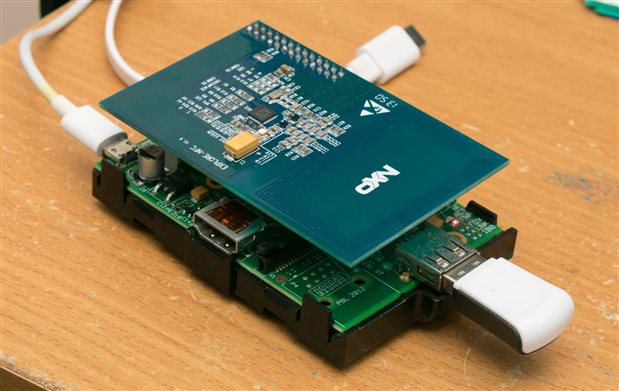

About six years ago, I had already purchased everything necessary to make a proof of concept trial of the idea - but I never had the impetus to try making it happen until now.
The parts used included:
  • Raspberry Pi Model A - this is the bare-bones original model A with just one USB port and no network connectivity. Feel free to substitute a modern Raspberry Pi - it should work just fine.
  • Wi-Pi Adapter - as the Model A has no connectivity, I used the Wi-Pi to add Wi-Fi connectivity to the unit.
  • Sandisk 4GB MicroSD card with adapter - another small "scrap" card I had lying about - any card bigger than 4GB would do just fine.
  • NXP NFC-EXPLORE add-on board - this provides the PN512 NFC radio interface with onboard 4-turn printed trace antenna and forms the transmitter.
  • USB 5V/2A power supply and USB A to micro-B cable - to power the Raspberry Pi.
  • Icom IC-R20 Communications Receiver - for handheld monitoring of the signal while moving about.
  • Degen DE1103 - tabletop portable shortwave receiver with SSB, as a secondary monitoring station.
  • Winradio WR-G31DDC SDR - to monitor the signal locally on the computer while comparing it with signals from other KiwiSDRs on the web.
In order to get this set-up, I followed the following procedures:

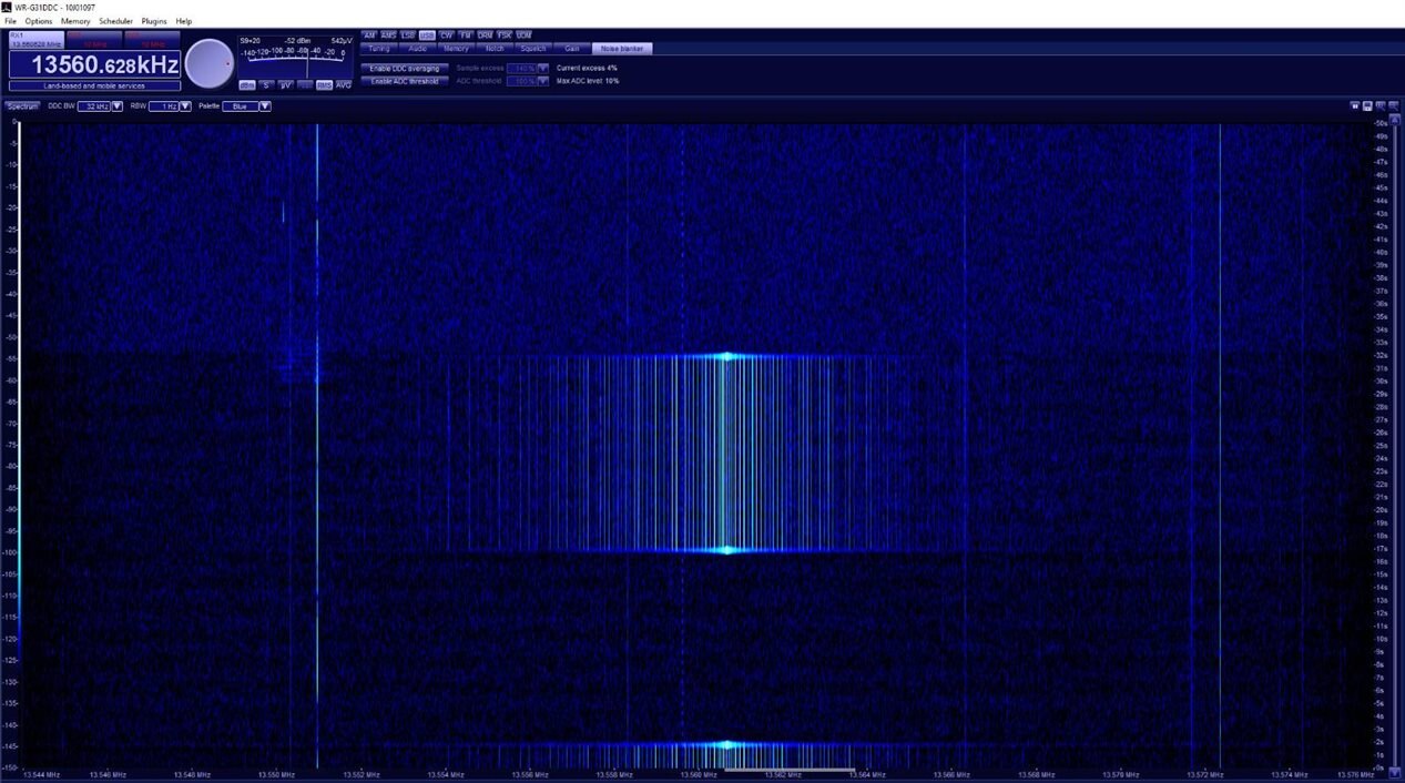

The first step was to see whether the signal was visible at all. Turning on my Winradio Excalibur WR-G31DDC, I was greeted with the signal from the NFC reader at 13560.628kHz. Considering that my WR-G31DDC has been calibrated to <1ppm compared to time reference stations WWV/WWVH, I'd have confidence that we know the frequency to within about 20Hz.

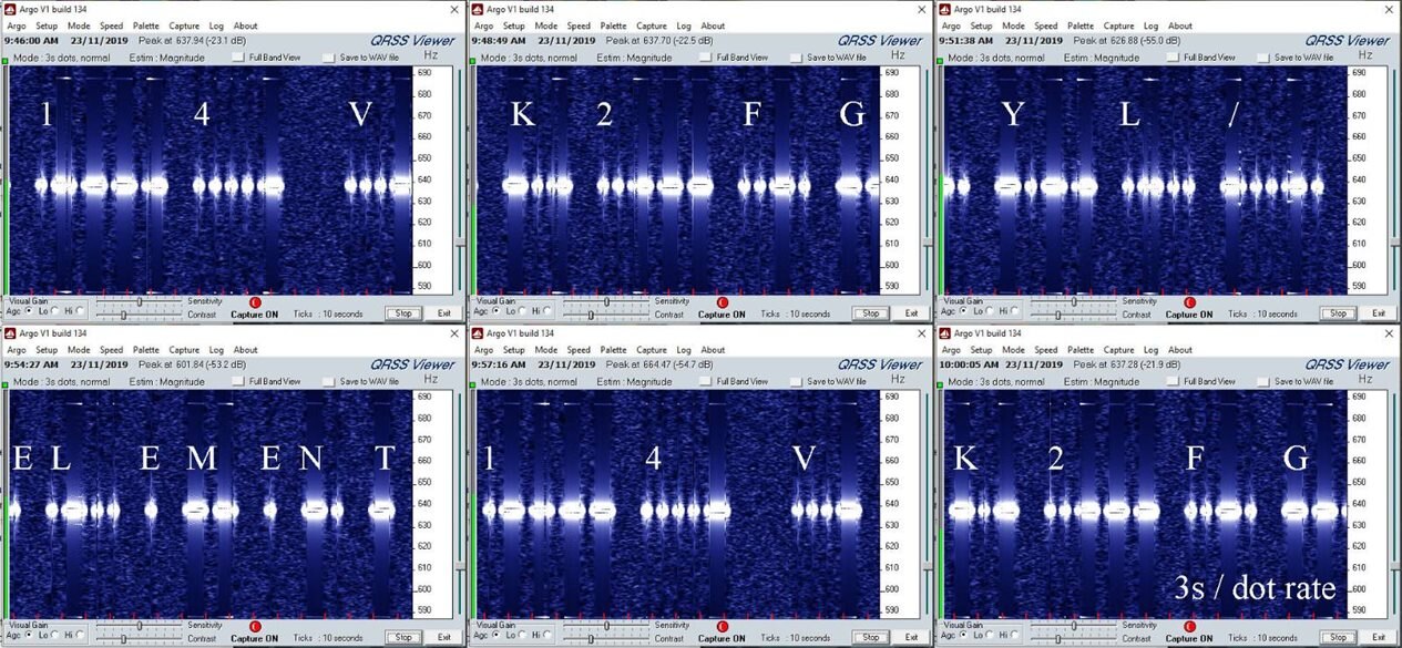

Changing the message to my callsign followed by element14, it was possible to get this plot of the output using Spectrum Lab examining the audio output from the SDR in fixed gain mode via a Virtual Audio Cable. At a dot rate of 0.5s/dot, it was possible to get a decent morse code representation, although the timing wasn't quite perfect due to delays within the Raspberry Pi. Given this was not its intended use, I am inclined to forgive these timing transgressions. The signal also seemed to have some harmonics and a rather rough note - this is not unexpected, as it was not a transmitter designed to have the best output purity.
I changed to a slower 3s/dot rate for a better signal, this time using a software called Argo which is a much simpler software with QRSS settings pre-configured. At the slower rate, timing variations were much less compared to the dot length, to the point of not being noticeable. I decided this would be a good time to see if my signal would propagate - as QRSS seems to show signals travelling over 1000 miles per watt, so with about 0.1W at a guess, I should be able to get about 160km assuming the best.

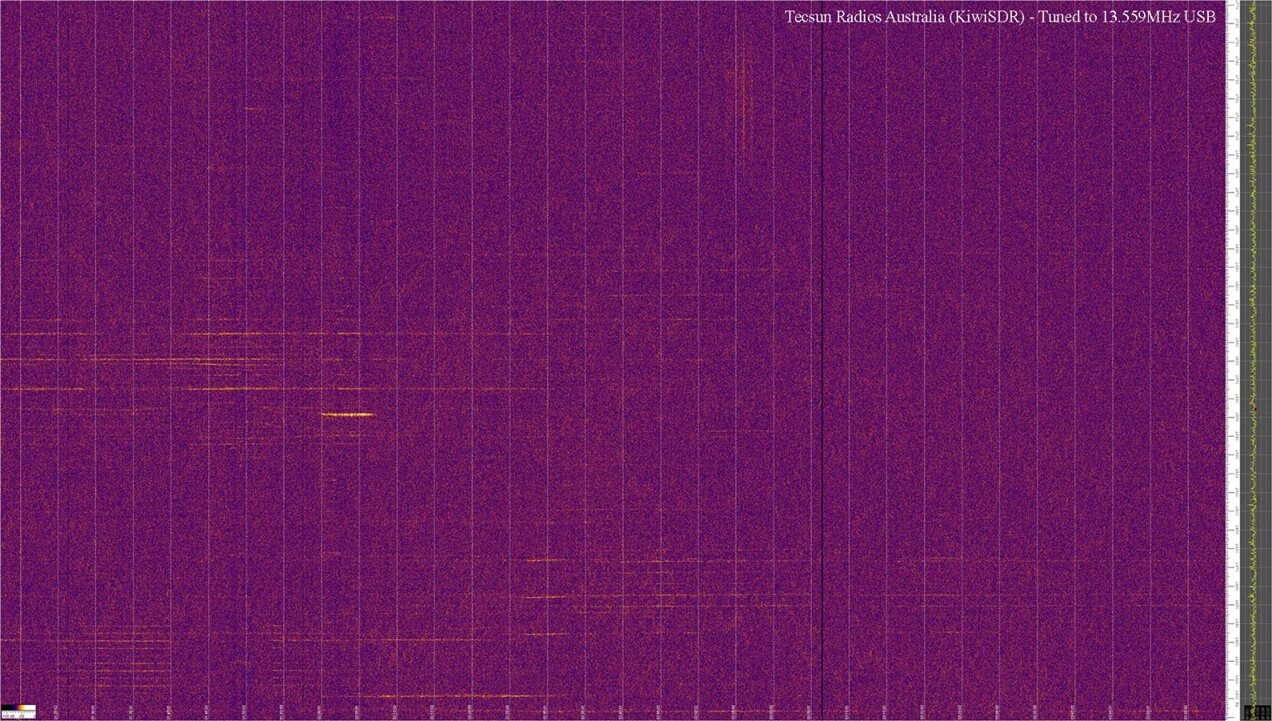

I opted for the longest 90s/dot rate to maximise my chances of travelling far. I selected Mediaexplorer's KiwiSDR in Freemans Reach, just 20km from my house, with my NFC EXPLORE card pointed towards the receiver at the highest point in the house. I configured the KiwiSDR receiver to play through the virtual audio cable into Spectrum Lab, but also configured my local Winradio SDR to output a band-limited signal, shifted downward in frequency, so I can see my own transmission and try to correlate it to what was being received from the remote receivers via the internet. It was only through this exercise that I could see the frequency instability of the NFC radio which was not ideal, but also the fact there is competing interference from other NFC devices which seems to come and go. Unfortunately, in the band where I expected to see something, I saw nothing. I suspected that the first receiver I chose may have had a higher noise floor, so I chose Tecsun Radios Australia's KiwiSDR which was further away - but even there I had no luck.
I monitored for a while longer without the local receiver - while there were the occasional traces of noise, nothing "beacon-like" appeared. Signals did not fade-in or fade-out as I had hoped - maybe propagation wasn't favouring me. But I decided that perhaps I was too ambitious from the outset and needed to scale back my expectations slightly.

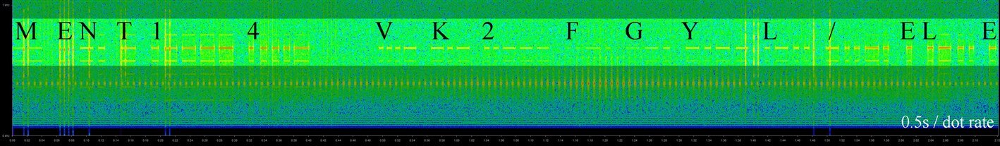

Going back to a relatively quick 0.5s/dot rate which I could tolerate listening to, I walked around the neighbourhood with my communications receiver and a whip antenna about 60cm tall. In all, I could only hear my signal from a distance of about 70m away - further than that, it seemed to disappear into the noise, but a slower dot rate and FFT display could probably bring it back out. More than that, competing sources of interference made themselves audible, although due to their frequency offsets, it was possible to distinguish my transmission from theirs. In all, I concluded that it was likely that the antenna itself was not designed to be a good radiator - instead, it was designed to inductively couple with smart cards and tags, hence a modified antenna would be necessary if the range is to be extended significantly. However, from this walk test, the fact I even reached 70m was an achievement in my eyes - audio attached to this post at the end, recorded from the IC-R20 using its internal IC Recorder.
