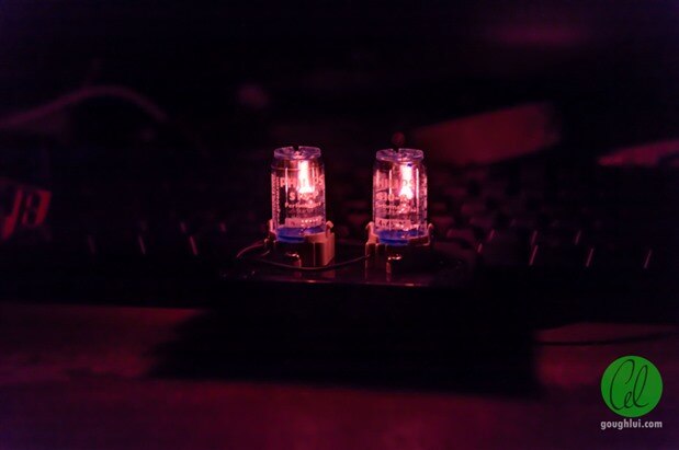

    Thanks for the encouragement ... my last "arty" project would have been this one from 2015:
    http://goughlui.com/2015/05/22/project-a-fluorescent-starter-based-glow-lamp/
    I guess as a "young bloke" who never had any memories of "warm glow" from tubes, this was the closest I got image.
    Been staring at this each night for years - but with all the sputtering of the bimetallic strips, it's gotten a lot dimmer with the metallic deposits on the inside of the glass envelope. Luckily, it's not hard to grab a few more fluorescent tube starters to run (after the RFI suppression capacitor has been cut out).
    - Gough
