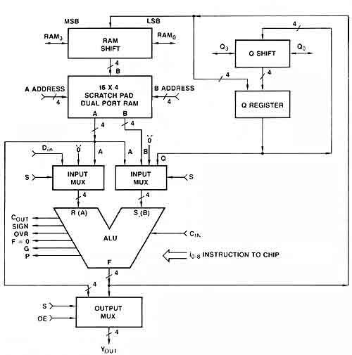

NexGen: Question is it possible to build a ARM7 Core from AM2901 Bit Slices?
phoenixcomm
phoenixcomm
25 Aug 2019
ARM 7 CoreAMD AM2901 Bit Slice ALU
This started with the wonderings of my rabid mind. In a comment to Project 14 You Decide
These are the two processors first I would have to add a register file. And since I like UltraSparc well it had 144 general-purpose registers + 8 registers just for fixed-point operations.  Where to put the register files, Barrel Shifter and Address Register/Controler are questions that I can't answer at the moment.
Maybe more who knows?
Cris
  • clem57
    clem57 over 7 years ago +3
    I think I would approach this differently and use an FPGA to mimic the ARM7, unless you just happen to have the AMD 2901 bit slicer around. So why did you pick this? Maybe an 8501 would be better since…
    DAB over 7 years ago in reply to dougw +3
    Hi Douglas, You could probably do most of the MSP430 with the 2901, but it would be very difficult to do all of the energy and pin management options. That said, you could do the instruction set with most…
  • phoenixcomm
    phoenixcomm over 7 years ago in reply to clem57 +2
    Yes, I happen to have 4 of them stashed away. I taught a class over at TRW in the mid70's and worked for Interdata (Perkin-Elmer bought them) used 2901s in all their CPUs. while I was there I built my…

    I think I would approach this differently and use an FPGA to mimic the ARM7, unless you just happen to have the AMD 2901 bit slicer around. So why did you pick this?  Maybe an 8501 would be better since it is widely used and fairly well known. ARM7 just seems too variable and the designs are licensed and hard to come by. Just my own thought here. But  phoenixcomm you may have your own set of assumptions. Care to elaborate?
