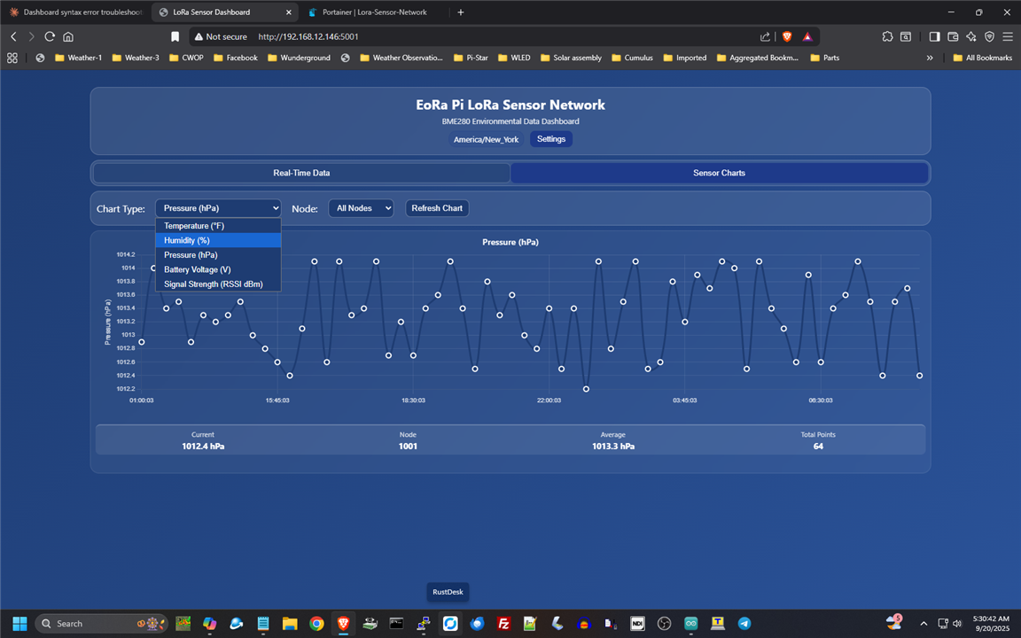

Arduino Forum "LoRa BME280 Sensor Network" `45 µA Node average with radio.sleep and deep sleep of 14 minutes out 15 minutes.

"LoRa BME280 Sensor Network" a collaboration between Anthropic's Claude and William Lucid.
Project requires two, "Ebyte" EoRa-S3-900TB Development Boards; one for Gateway and one for Node. One 74HC04 for each node to reroute the Lora DIO1 signal to a wake capable GPIO_RTC pin. One BME280 for each node.  Developed and tested with the EoRa-S3-99TB; other LoRa development boards may work, code modification left to hardware owners.  Supports mutiple nodes.
