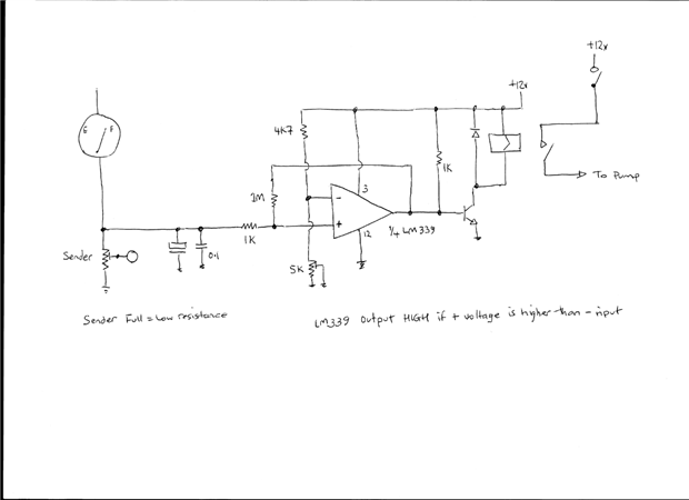

Im looking for guidance with my first project.
Background for this project.
I have a 100gal diesel transfer tank in my truck. From this tank i have a small 12v pump connected to the fuel tank of my truck, i use this pump to fill my truck on long trips, or if i get into areas where i cant get to a filling station. The problem I have and the reason for this project is the pump is SLOW. That in itself isnt the problem, the problem is that i sometimes forget to turn it off, and yes i have forgot about it long enough to dump 70+ gallons of fuel on the highway ( expensive mistake)
Scope of this project;
I would like to use the fuel sender in the truck tank to turn off/interrupt power to the coil of the relay controlling the pump at a set level ie. 7/8 full. This way I can turn on the switch and if i forget to turn it off i will no longer over fill the truck.
Since this is my first attempt working with arduino im not really sure where to start.
Tomorrow morning I'll be taking some measurments of the fuel sender although im pretty sure it is resistance based.
So i guess the first thing i need help with is interfacing with the sending unit without adversly affecting the guage on the dash.
After this part of the project is complete Id like to also monitor the sending unit in the transfer tank so when that tank is empty ( or at some set point ie. 1/4 tank) also turn off/interrupt power to the coil of the relay controlling the pump so as not to burn the pump out from running dry.

    jamesb128 James A simple voltage comparator circuit using an OpAmp will give you all you need. It's late and bed calls but maybe if jw0752 is still up he will have the circuit and have proved it before…

    jamesb128 Welcome to the world of electronics, and Arduino. Before you start you're going to have a couple of problems. 1. The sender and guage are 12v (or 24v) which is incompatible with the 5v of the…

    Hi mark thanks for your reply. Im certainly not tied to using an arduino or any other microcontroller for that matter. Only reason i chose to use one is well i have it and i was looking for a starter project…

    Okay
    I gave up on trying to use my normal schematic package ... it sucks
    Here is the old fashioned version. No guarantees but it should give you a good start point.
    I think I've got the logic correct, and I've assumed the sender goes low in resistance when the tank is full.
    This is the turn OFF at 7/8th full version.
    The LM339 has 4 comparators and they suggest tying the unused inputs to ground.
    Using another 1/4 of the LM339 you should be able to duplicate to make the "Turn off at 1/4" but you need to swap the inputs so that the preset part is on the +ve input and the sender part is on the -ve input.
    You can add the relay output in series.
    The capacitor across the sender should help smooth the fluctuations but will need to be sized according to the sender resistance. I suspect a 1000uF might be needed.
    The 1M and 1K for a feedback to stop it oscillating when it's close to the trigger point. I suspect the pump and tube will also give some additional hysterisis so it may not be required.
    In theory a couple of LED's (with resistors) at each point in the voltage feed will show the switch is ON, the receiving tank is READY and the supplying tank is OKAY.
    You may want to change how the power is fed so that the switch is the final part, that way you can have a LED to prompt you to switch it ON.
    You have enough spare inputs to create a third section to prompt you when the tank is below 1/4 ....
