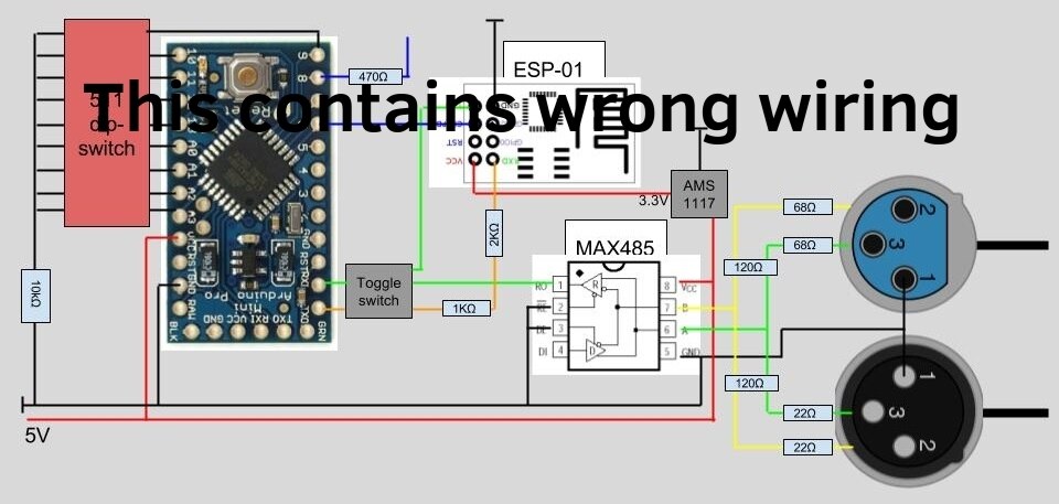

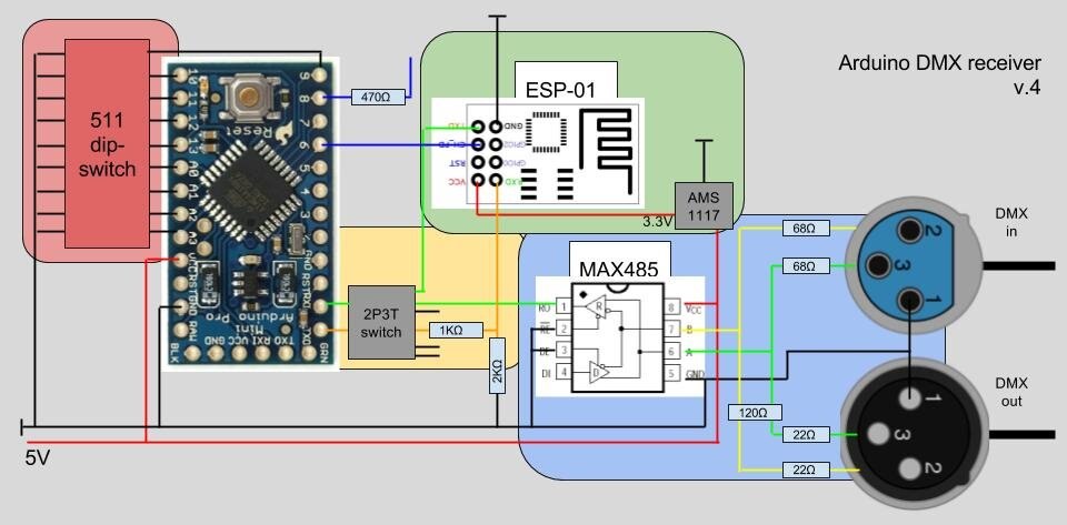

I am trying to design an Arduino based DMX receiver for use in a show where we have some custom builds.
In this case; we want to control a LED strip over DMX.
The design has 2 options for control: over DMX or WiFi. The toggle switches between DMX, WiFi or none.
The WiFi will be for debugging/testing of when using at home.
For what I found as seen in the image, I have some questions / doubts about some elements:
  • Are the resistors correct? Especially the 68, 22 and 120 Ohms.(one 120 ohm at the end)
  • Will this wiring work for the MAX485?
  • Is it needed to disconnect Rx/Tx prior to flashing new programming on the Arduino?
  • Is the ESP-01 done correct? (improved again in v3)
  • Will the dip-switch work this way? (Arduino sets pinmode input_pullup)
  • Is the 470 Ohm resistor advised for controlling the LED strip? (Seems advised for pin protection with power-on current)
Old design v.1:
Design v.4:
Notes:
  • The Arduino is the 5v version
  • The 470 Ohm resistor goes to the LED strip
  • The LED strip has its own power
  • The toggle2P3T slide switch has the states [Rx+Tx > ESP], [Rx > MAX485, Tx > none], [Rx+Tx > none]
  • The build will be done in phases (LEDs>red>green>blue>yellow) to keep it all working
If someone has remarks, improvements or questions; keep 'm coming image
I am still not very experienced in this stuff, but you learn best by doing image
Message was edited with v2, v3 and v4 in bold.
v1 replaced for search engines.
  • WarrenW
    WarrenW over 9 years ago in reply to bytebitten +1
    The issue with this is that lets assume the internals of the arduino has a resistance to pull up the SINGLE pins. When you connect a SINGLE resistor to MULTIPLE pins how will that interact with the other…
  • c4m4ch0
    c4m4ch0 over 9 years ago +1 suggested
    Ruben, see the following image to see how the voltage divider it is done (1k and 2k resistors).

    0 COMPACT over 9 years ago in reply to COMPACT
    The 120 Termination resistors are only used as required - at the ends of the DMX connection bus only.  A jumper should be used to connect or disconnect it.
    Why have you lost the 22 ohm and 68 ohm resistors?
  • COMPACT
    If use the 3v3 version of the Arduino Mini Pro then you done need the AMS1117 regulator or the two resistor divider network (but you may (or may not) need some additional interfacing.
  • bytebitten
    0 bytebitten over 9 years ago in reply to COMPACT
    I have not found yet if they are recommended for safe usage.
    I will do some more research on that today.
