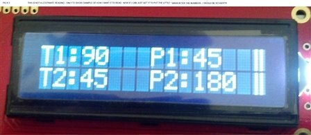

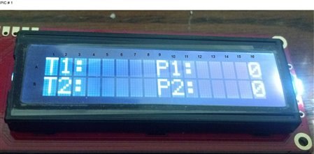

    So I purchased a Serial LCD (sparkfun PN RTL-09877)
    I hacked some code from Sparkfun’s website and so far so good..well to a point.
    I have attached 2 pics and will need to be used to reference information I am speaking about.
    each column and  row are assigned coordinates by me
    Here are my questions:
    1. 1. What is the opposite of random as seen in lines 43 through 46?
    2. 2. Why am I getting the zeros in PIC # 1: A16 & B16?
    3. 3. Would these same lines cause B1 & B2 to also randomize as seen in pic # 2?
    4. 4. Right now just looking for an answer to this one, its regarding PIC # 3, writing the location to the lcd in degrees.
    Note regarding pics.  PIC # 3 are NOT legitimate readings, I added them for the purpose of this question.
    To explain further:
    As you will see in PIC # 1
    I have programmed the Arduino to write T1: (across A1, A2,& A3)
    I have programmed the Arduion to write T2: (across A9, A10, & A11)
    The information in row B, is the same for the exceptions, B row will be for T2: and P2: respectively.
    So info in these rows and listed columns are to be static.
    Now if you would please, focus on A16, and B16 (STILL ON PIC # 1)
    Those 2 zeros, is actually random information (a random generation of info is NOT needed for the project)
    I am pretty sure that the location for this small little glitch will be found in the following lines.
    1. Lines 43 through 46 -  I have the RANDOM(1000) listed ß what is the opposite of random?
    Now to use PIC # 2
    In this pic we see that the following locations are changing (A16 & B16)
    But notice locations: B1 & B2.  These 2 locations have changed from T2 do randomization.  This one I don’t have a firm grip on but believe its somewhere around the following lines:
    Lines 60 up to 70
    Finally PIC # 3
    This is what I need to have showing up.  As in previous postings, I am looking to get the °’s of each pot, when I turn the servo.  My thought process tells me that I need to actually figure out where each given servo is at a certain point of the potentiometer, therefore I would need to have the coding reference the location of the pots.
    1. WOW…ok guys, we are doing so well…I hope you see that I am trying and really attempting things before I post questions…  J
    ~Anna
