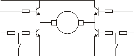

Hi all I have finished one part of the dc motor controll program, this has subroutines for moveForward and moveBackward.  There are also limit switches set up for leftLimit and rightLimit.
What I would like next is to initiate a routine by a single press of goButton.    The table would then moveForward until leftLimit goes high, then stop and moveBackward until rightLimit goes high and stop and wait for next goButton to start next cycle.   The problem is the goButton and both the limit switches will not stay high,  they will just be high for a short time to initiate  the action , but the action has to go on until the next input.
Hope I have explained this well.

    The most reliable way is to use limit switches in series with the motor. Especially if damage might result in case the motor drives beyond the limit. Not only an error in the code but also faulty transistors…
    0 dougw over 11 years ago
    Hi Gerhard,
    If you want to hard wire motor protection, but don't have 65A limit switches, you could try something like this:
    The limit switch voltage could be set by the resistors to be compatible with your digital inputs for software monitiring.
    Note that if this uses PWM to adjust speed, software monitoring is more complex.
    Doug
