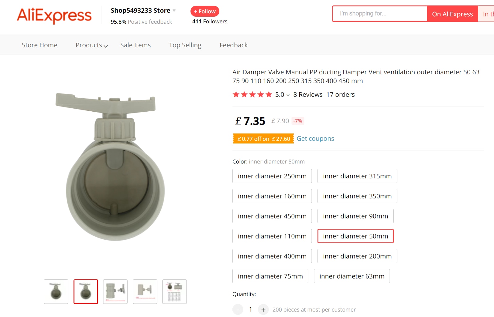

    shabaz over 4 years ago
    Just to throw out another idea for ruling in/out (if you have not already done so), there is this sort of (manual) valve, I don't know how effective it could be, it would turn the problem into one where a hobby-servo rotary motion could shut/open each port (i.e. it would need to be replicated one servo per port) - probably a more expensive solution though. Still, maybe worth an experiment on just one port perhaps, the advantage being that no power control circuitry is needed, since usually hobby servo-motors can connect directly to microcontroller GPIOs, and also no feedback is needed (since servo's have that inherently). You may have some different issues however, such as detection of stuck mechanisms, which can cause servos to smoke or fuses to blow.

  • beacon_dave
    beacon_dave over 4 years ago in reply to shabaz
    Waste material may get stuck with a vane type valve like this. An iris or gate type valve may be better as it would tend to leave the port clear when fully open.
