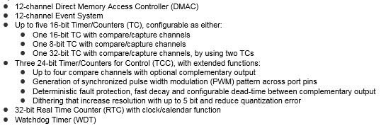

    I am still learning this microcontroller myself and don't have the Adafruit board.  The honest answer is I don't know whether it is right or not for the Adafruit board.  One way to find out is to write a short sketch that tries to apply PWM to each pin you want to test and put a LED on it and see if it dims.
    It is worth remembering that Arduino purposely abstracts all this detail away to make it simple to use.  Once we need greater access to the capability that is hidden by the abstractions it is sometimes easier to use a more professional IDE from a clean slate and access the registers directly.
    Looking at the datasheet again, we find this snippet in the features that covers timers:
    I take this to mean that there are three 24-bit timer/counters set up for explicit control of PWM which Atmel calls Timer/Counters for Control (TCC).  They are labeled TCC in column F of the multiplexing table.  Looking at this table and what pins are brought out would tell us where Adafruit could have chosen to use these timer/counters to control PWM.  You might try looking for the variant.cpp file for your board.
    PWM is pretty simple, if maybe somewhat tedious, to set using registers.  Basically choose a pin connected to a timer/counter and set up a clock to the timer/counter.  Set the registers for how long the pin is high and how long it is low.  Twiddle other bits as needed.  This is all done in hardware without interruption to the microcontroller.  But we could do it without that hardware support.  We could use any timer and set it to interrupt after say a certain interval high.  In the interrupt flip the pin low and set the time for the next interval.  Then flip the pin again and reset the interval.  Repeat over and over.  In this way, any GPIO could be used for PWM.  It may be possible to do either of these approaches within the Arduino IDE but I don't know what conflicts it might introduce.
    I know this can be confusing but hopefully helps.  If you test the pins as described above I would be interested in what you find.
