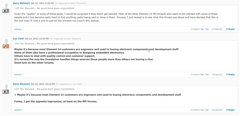

    shabaz over 7 years ago in reply to gdstew
    What's with the quote-marks around "opinion" : ) I didn't ask you for your formed opinion, nor to withhold it. Open up and release it if you like. It's your choice.
    Here's mine: Gary, you've always had issues. Not just with me, but others who have sadly left over the years too.
    Just an example - it's clear what your opinion is/was of your peers here - this was one of your very first interactions on the forum with your peers or inmates at the asylum as you termed them:

    P.S. Thanks for taking my responses completely out of context to the discussion that was ongoing at the time on that particular forum as I noted
    in one of those responses. There were more than one or two "crazies" on there at the time and I was not the only one to say so. I would also like
    to note that a few of those "crazies" managed to get themselves banned from this web site, and I didn't.
    It is clear how you felt about your peers at the time, and that's just one documented example.
    You might call them 'crazies', I'd say it says more about you that you're willing to write off people like that.
    Just an opinion (and not a particularly high one of you as a result).
