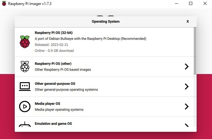

Next, choose the OS type.
Then select the drive. One of the great features of this tool is we can add the SSH and Wi-Fi credentials directly into the OS file, even without turning on the Raspberry Pi. For that, select the settings icon in the tool.
Next, start burning the OS into the SD card.

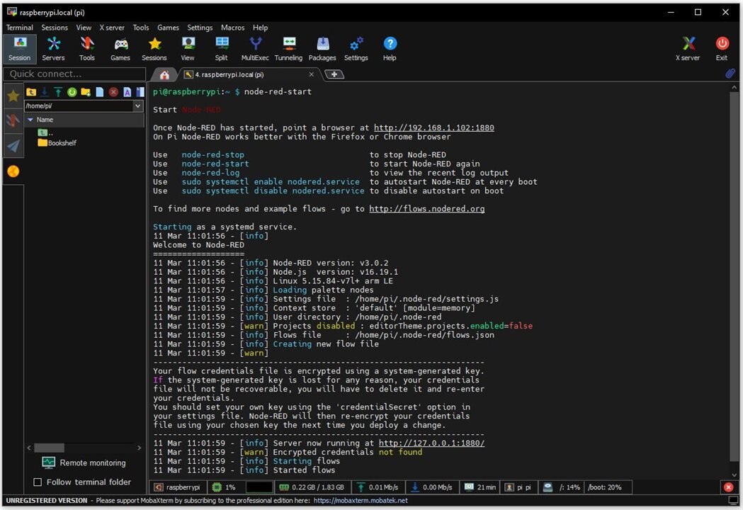

Type the following command in the Raspberry Pi SSH to install the Node-Red.
bash <(curl -sL https://raw.githubusercontent.com/node-red/linux-installers/master/deb/update-nodejs-and-nodered)
You need to give some input to the system in order to install the Node-Red. Type Y to install the Node-Red.
The first time, it will automatically install Node.js and all the other necessary components. Once the installation is done, type the following command to start the node-red.

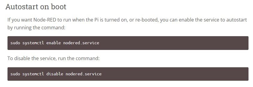

We can make the Node-Red auto start at boot using the following commands.

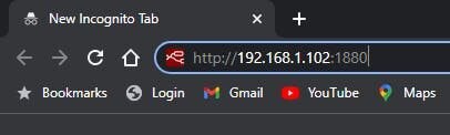

In the console, you can see the IP address.

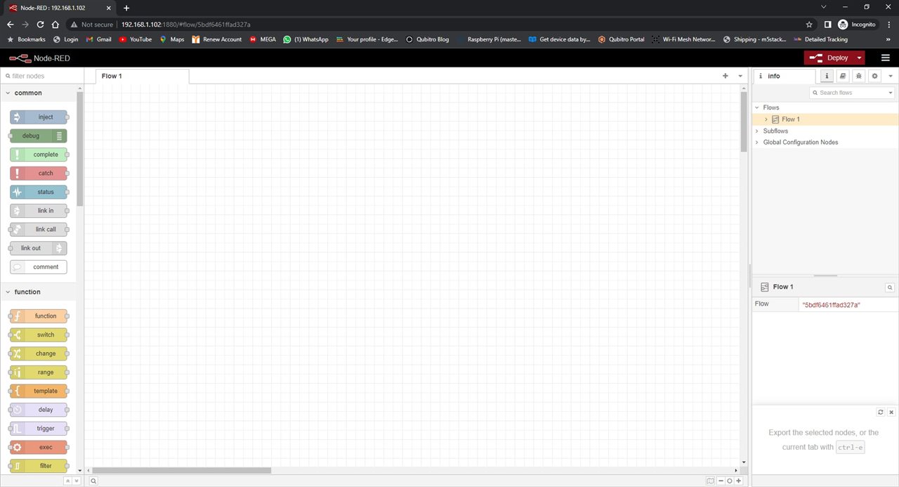

Just type in the IP address in your browser, and it will open up the Node-Red dashboard.
