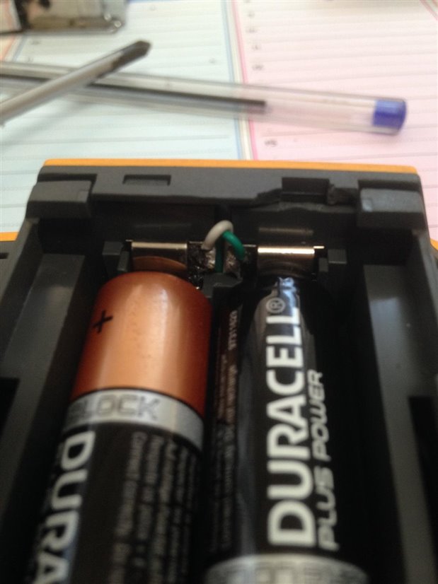

I have had my Fluke 233 just over 4 months now, over which time it has  had pretty light use. Which is why what I am about to say is a bit of a  surprise.
In my review I wrote:
Batteries.  400  hours  estimated life is  excellent. That probably works out at 3 to 4  years  usage for me. But,  when they go, it does mean potentially 5  batteries  have to be replaced.
I have used it for maybe 5 hours use  at the outside, and not at all for the past month or so (sadly, my  engineering has mostly been on paper or PC recently). That doesn't sound  much, but it adds up to quite a few voltage and resistance  measurements.Anyway, I came to use my Fluke 233 today and this met me:
http://i222.photobucket.com/albums/dd237/Zadpics/FlatBattery.jpg
Pretty much running on empty! Removing the remote head results in a BATT  warning and no measurements are possible. If I am going to be  installing a new set of 5 batteries every 4 months then it becomes a very expensive meter! I had thought that using high energy density AA  cells was a good idea (the cells it came with were brand new Duracells  with a very long use-by date), but maybe Fluke are covering up some  nasty quiescent current use. Swapping out the batteries allowed me to test  the off-load voltages, which were all around 0.95-0.96 Volts, so that rules out a rogue cell failure. My investigations with my trusty Fluke 77 (battery age 4 years) revealed the following:
Body power consumption, power ON = 3 to 6mA
Body power consumption, power OFF = 0.9 to 1.1mA
Display unit, power ON = 3 to 3.6mA
Display unit, power OFF = 1mA
Looking at http://www1.duracell.com/oem/Pdf/new/MX1500_US_UL.pdf the nominal capacity for <5mW drain is 1600 to 2300mAh (to 1 volt). 2300mAh at 1mA, is 95.8 days...
You  will note that an "on" life of 3mA is 766 hours, and 6mA is 383 hours,  which averages close to the specified taget of "around 400 hours".  Presuming you use your meter 24 hours a day, and don't actually switch  it off...
Given the recently found RF vulnerability in the Fluke 87 V, it does   make me wonder if Fluke are taking their eye off the ball. It surely cannot be right that a   meter eats a set of 5 cells in 4 months, especially given such light   usage. This is certainly not the sort of meter to leave in your tool case, because chances are that the batteries will be flat when you need it.
If any other Fluke 233 owners have experienced any similar failures, please let me know!
If any Fluke reps see this: Is there a known fault with the 233? Because this does look like a bit of a killer design issue.
Mike

    Hello Viewers, The 233 is unique in its design and implementation with its wireless display utilizing both iR and RF communication between the meter base and the remote display. While docked the meter utilizes iR communication and when the display and base are separated RF communication is used. When new the meter is shipped with paper tabs inserted into the battery compartment for both the base and the display to keep the batteries disconnected from the meters power supplies. This is to insure that the batteries have a full charge and the customer gets the longest battery life possible. The reason for a short battery shelf life is that when the meter is turned off and the display is mated, the iR communication is still active. This was done by design to give the user the most flexibility when using their 233 meter. The design allows the user to power on and to wake up the meter while the display and body are disconnected. It simplifies the meters operation. This use model was important to customers during our initial research for the 233. The alternative would have been to have two separate power buttons, one for the base and one for the display. Our research indicated that this was a less attractive solution to our implementation of one power up option for both parts. The trade off is the unit consumes more power but gives the users more flexibility. If the meter were to go into battery save mode and the iR communication were not active, the display and meter body would need to be re-connected before the display could power up. This option and two separate power up processes were not attractive in our research. To optimize the battery life, for intermittent use or extended periods of storage, it is recommended that the paper tabs be re-inserted into the battery compartments or the batteries be removed completely. Jim Newell Sales & Application Engineer Fluke Corporation

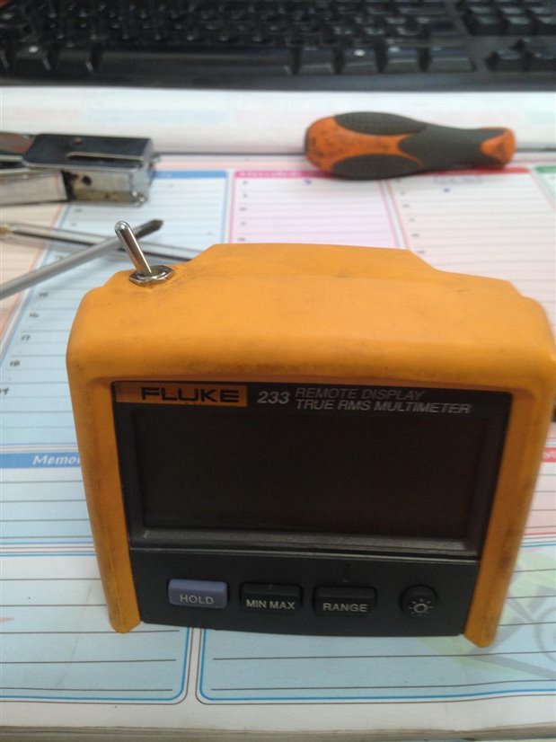

    I have experienced the same problems with my unit (as Mike & Patrick have noted above) ... I have used my unit very 'lightly' ... total "ON" time is probably < 20-hours.  I always turn if off when I am not using it to conserve on batteries ... well, so I THOUGHT.  image
    The batteries are being slowly depleated even without use ... seems like a design flaw (or oversight).  I wonder if there is a way to fix this with a firmware update that would power down the unit completely?

    Coincidentally, the batteries of my Fluke 233 died last week, after approximately 4 months of light use. As I suspected in my review and which you confirmed above, it is not possible to turn off the Fluke 233 completely, causing it to eat batteries, even when it is not in use.
    In their next wireless multimeter, it might be wise for Fluke to include a On/Off switch on the wireless module, to allow users to switch the meter off completely when it is not in use. For the Fluke 233, I can only recommend removing the batteries when the meter is not in use, although this is obviously not a very elegant solution.
