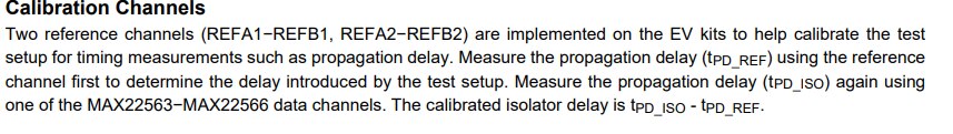

The evaluation kits are designed to evaluate the MAX22563−MAX22566, a family of reinforced, six-channel, galvanic digital isolators in a 20-pin SSOP package.
Two types of evaluation boards are available:
  • The MAX22565CAEVKIT# is fully assembled and tested, and comes populated with the MAX22565CAAP+ (Not used in this roadtest)
  • The MAX2256XAEVKIT# is a generic board that has U1 unpopulated, allowing to select a device from the MAX22563−MAX22566 family. This is the kit that will be used for this roadtest. The MAX2256XAEVKIT# comes with U1 unpopulated and supports the following digital isolators: MAX22563BAAP+, MAX22563CAAP+, MAX22564BAAP+, MAX22564CAAP+, MAX22565BAAP+, MAX22565CAAP+, MAX22566BAAP+, and MAX22566CAAP+.

You need some test equipment to roadtest the MAX2256XA EV kit:
• MAX22563−MAX22566 device if U1 is unpopulated on EV kit. (The roadtester and I will get together to order the desired device needed.)
• Two DC power supplies with output range of 1.71V to 5.5V
• Signal/function generator
• Oscilloscope
Note: The EV kit should be powered from two independent isolated power supplies with nominal output voltage in the range from 1.71V to 5.5V. To evaluate the electrical parameters of the device without any isolation between the two sides, a single power supply can also be used.
