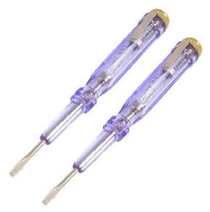

  • I have heard plenty of bad stories with regard to the neon screwdrivers. There are a number of issues with them in comparison to todays standards;
    1) The internal resistor is the only thing that prevents the user getting a shock, so is a single point of failure
    2) The neon can be difficult to see in bright light giving the impression that the circuit is dead
    3) They are easy to light up by capacitive coupling so can give a false positive
    4) Older ones were not sealed so would short out if damp got into them
    5) They are not CAT rated so are susceptible to voltage transients
    6) They are not GS38 compliant as they have in excess of 4mm of exposed tip
    There must be millions of neon screwdrivers in circulation and probably used on a day to day basis without issue. The modern ones are probably sealed much better, but the fundamental question is do you really want to be part of a test circuit when there are much better options these days?
    Neon screwdrivers operate in a different manner to the T6, in that you become part of a resistive circuit by direct contact. With the T6 you are capacitive coupled and have no direct contact with the voltage you are testing.
    Kind regards
  • What could possibly go wrong? image
    I can just seem myself grabbing the wrong screwdriver and making the test even more interactive.
    And the little kids watching will always copy what you're doing.
  • For what its worth, I will NEVER use one of these.
  • Well, I'm not an expert but a Screw Driver Voltage Detector also encourages you to be part of the test circuit and haven't heard any bad stories about it, just saying.
