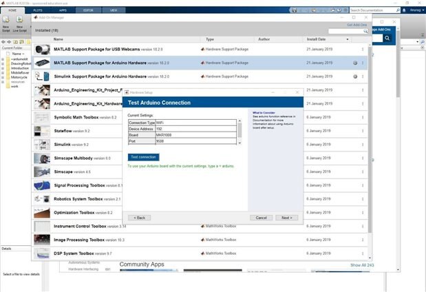

  • Hi
    In the chapter 6.4: BALANCING WITH STRAIGHT MOTION it asks to remove the usb cable to connect to wifi.
    First I already did tests and the MKR 1000 is assigned a wifi port as you can see in my last comment but still it gives me an error that I should connect  a usb cable to the mkr to run with wifi. Why is this so? The motoSys2_balance.slx file is not able to find the mkr wifi address it looks like. Can you help as why this happens?
    The error msg as here below
    The following error was encountered during evaluation of the external mode callback 'getExtModeData': codertarget.arduinobase.internal.getExternalModeMexArgs('Wifi')
    Could not automatically set the host COM port for your MKR1000 board. This may be due to a disconnected or unrecognized board.
    If the board is not connected to your host computer, connect it and let Windows install the board driver.
    If the board is connected, update the board driver. Open Windows Device Manager and locate the board either in Other Devices or in COM Ports. Right-click on the board and select 'Update Driver Software...' Next, select 'Browse my computer for driver software'. Specify the search location as C:\ProgramData\MATLAB\SupportPackages\R2018b\3P.instrset\arduinoide.instrset\arduino-1.8.1\drivers and click 'Next'.
    If Windows still cannot automatically set the COM port for your board, set it manually. In your model, click 'Simulation ', click 'Model Configuration Parameters'... In the dialog that opens, select the 'Hardware Implementation' pane, click 'Target hardware resources > Host-board connection', change 'Set host COM port' to 'Manually' and set the 'COM port number' to match the port number in Windows.
  • Hi
    After the re-installations I also did the re-test with USB and Wifi connection which works now. So atleast the wifi error is gone
    but the compilation error is existing.

    I think there is some issue in the make-build file when compiling the motoSys2_balance.slx
    Can you help with this please?
  • The libs that I have installed as mentioned in the tutorial. I already have the existing files as suggested on webpage
    the latest release (R2018a) and have access to the following products: MATLAB, Simulink, StateflowRegistered, Control System ToolboxTm️, Curve Fitting ToolboxTm️, DSP System ToolboxTm️, Image Processing ToolboxTm️, Instrument Control ToolboxTm️, Optimization ToolboxTm️, Signal Processing ToolboxTm️, Symbolic Math ToolboxTm️, SimscapeTm️, and Simscape MultibodyTm
    Then I installed these files with admin rights again today with the correct admin rights
  • Can you tell me how to reach out to the Mathworks TS team? Is there an email available ?
  • I would suggest reinstalling with admin access. There is some issue while you are downloading. So uninstall the support packages and then close MATLAB. Reopen MATLAB by right clicking on icon and select Run as administrator. Then install the support packages.
    If this also fails reach out to Mathworks TS and ask them specifically for how to install from folder option so that you can download and confirm that the necessary files are there.
