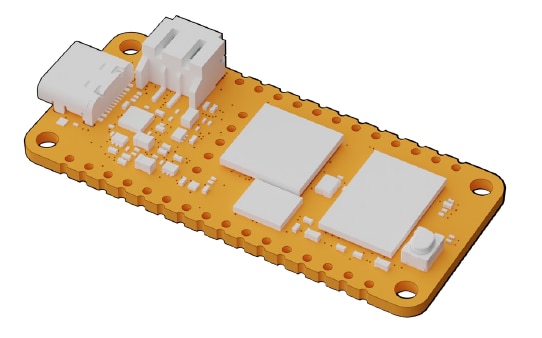

OrangeCrab is an electronics development board. It is FPGA based, featuring an ECP5 from Lattice. The board follows the slim feather board specification from Adafruit. The FPGA is compatible with the opensource toolchain and is perfect for experimenting with RISC-V and other softcore SoCs.
orangecrab dev board
Features
  • Lattice ECP5 FPGA csfBGA285 package(LFE5U-25F-8MG285C)
  • On-board DDR3L memory
  • Direct USB-C connection to the FPGA
  • FPGA based Full-speed (12Mbit) USB
  • 128Mbit QSPI FLASH Memory
  • MicroSD socket
  • High efficiency DCDC for main supplies, battery charger (100mA), lipo battery connector (PH type)
  • 48MHz on-board oscillator
  • User I/O(1x button, 1x RGB LED, 20x I/O on 0.1" headers, 6x analogue compatible)
  • Dimensions: 22.86mm x 50.8mm (0.9" x 2.0")

  • Even if it only has the functionality of a micro USB connector, I still prefer it. I barely have any micro USB devices left, so I don't keep many micro USB cables around. It's also a lot more convenient and durable in my experience.
  • Github projects contains schematics for 3 revisions:
    r0.1 - with classic micro USB
    r0.2 - with classic micro USB
    r0.2.1 - with USB Type-C
    Farnell offers board with R0D2 label in product code but I am not sure if it is improved r0.2.1. According to description It should be.
    Also note that SBU wires of Type-C connector are not connected and CC wires are connected using standard 5.1k resistors to ground. No advanced Type-C configuration (power-delivery, dual port role, etc...) is possible. So I think it does not matter much because it offers the same features as a standard micro USB connector.
  • It's definitely confusing . The datasheet PDF seems to show the r0.2 has a USB-C connector according to the mock-up in the manual:
    That would be a nice feature to have indeed, but then the link posted only has micro-USB. Hmm. I wonder if could find out from the sponsor.
    - Gough
    Is this a new revision with USB-C, or just a mistake in the description?
