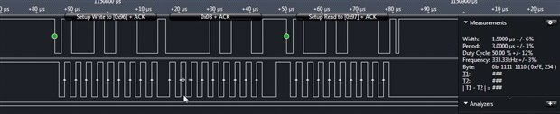

  • Worst thing about Freescale is there LACK of support. I have been trying to get the I2C working on my KEA-64 board for THREE WEEKS and all they can do is send me more demo code that is bloated and overly complicated.
    As you can see I have the I2C module mostly working, but nothing I try, including following what here myriad of examples shows, to do to get the clock KEA-64 to provide a clock for the device to send back data seems to work. I have tried this with TWO I2C devices and both give the exact same result so it must be the KEA-64. Their "help forums" are hardly any help so I am hoping someone here may have some REAL answers. I am including my code below, and hopefully someone can point to the error I have made in MY code.
    Kas
    int main(void)
      long int delay;
      unsigned char i;
      unsigned char result;
      char string[] = "My name is Bob C. Marley \r\n\r\n";
      Clk_Init();
      UART_Init();
      SIM_SCGC |= SIM_SCGC_I2C_MASK;
      SIM_PINSEL |= SIM_PINSEL_I2C0PS_MASK;
      I2C0_F = 0x11;
    /**/ //Start
      I2C0_C1 |= I2C_C1_MST_MASK | I2C_C1_TX_MASK | I2C_C1_IICEN_MASK;
    /**/ //Write device to read from
      I2C0_D = 0xC0;
      while ((I2C0_S & I2C_S_IICIF_MASK) == 0){
      //Wait for data to transmit
      I2C0_S |= I2C_S_IICIF_MASK;
    /**/ //Write register to read from
      I2C0_D = 0x0C;
    /**/ //Restart
      I2C0_C1 |= I2C_C1_RSTA_MASK;
    /**/ //Read from device
      I2C0_D = 0xC1;
    /**/ //RX mode
        I2C0_C1 &= ~I2C_C1_TX_MASK;
    /**/ //Turn off its ACK
        I2C0_C1 |= I2C_C1_TXAK_MASK;
        for (i = 0; i < 5000; i++){}
        result = I2C0_D;
      I2C0_C1 &= ~I2C_C1_MST_MASK;
        result = I2C0_D;
      while(1) {
        for (i = 0; string[i] != '\0'; i++){
        Uart_SendChar(string[i]);
        for(delay = 0; delay < 99999; delay++);
      return 0;
