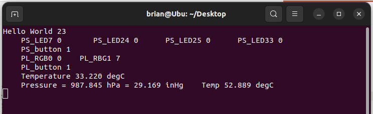

  • I'm not the most savvy with terminals in Ubuntu, I use an application called 'screen'. The command to start is:
    sudo screen /dev/ttyUSB1 115200
    • the ttyUSBx might be different on a different machine, you might not need sudo depending on your config
    • It works well, but you will not be able to catch the powerup from Flash, only on reset to see the full report
    • It might have been nice if the startup report was sent again if user hit 'ENTER' button on the terminal.
      • I cannot tell if it is even looking for terminal input... seems like it is just TX only

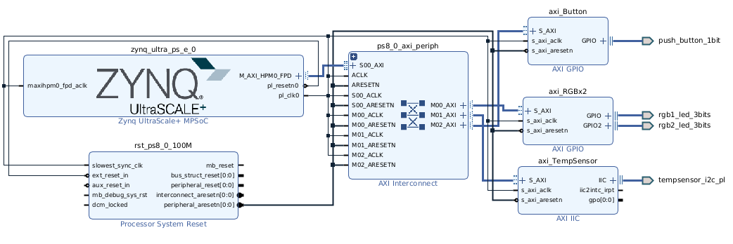

  3. Zynq component is inserted into block design, and has a board preset available
    1. image
    2. Some details of the preset:
      1. 33.333MHz reference clock -> 1200MHz Processor clock
      2. DDR4 set up for 533MHz (LPDDR4 1066)
      3. Some notes about the peripherals:
        1. Click port has pins assigned as board components with I2C, Reset, SPI, UART broken out for individual use.  I prefer this decision over a custom port, because it is easier to use a take control directly if you do not want to use a basic AXI peripheral.  For instance, you might want to use a reset controller for a Click peripheral to handle power on/off
        2. The 3-bit RGB are typically designed to be used in PWM mode to set brightness and color (mix), but I am not aware of a PWM AXI peripheral available by default in Vivado. You would have to write one. The GPIO attached would allow for the Zynq to modulate with AXI calls, but this is not a good way to handle a peripheral like this, you would rather send a setting and have the IP 'free running'. Avnet designed the board to safely turn on the RGB's because they have 3.3V with a 1kR resistor to keep the LEDs from burning out even at full power.
  4. Overall I think the board is set up well for my next steps
    1. image
    2. We are going to create a bare-metal PS application that toggles through the PL and PS LEDs, and reports button status, temperature, and pressure sensors
    3. If you are new to Zynq, a major difference between Zynq and standard fabric designs is that the Zynq (PS) is in charge of reset and clocks of the fabric
    4. Pressure sensor is an SPI port on PS (SPI_0)
    5. Discrete Temp Sensor is an I2C port on PL
    6. 1 push button on PL
    7. 1 push button on PS MIO 32
    8. For our PC terminal tty, we will use UART from the PS (through FT USB device)
  5. Don't forget to create an HDL wrapper for your block design (like I ALWAYS forget)

  13. On PC open terminal -> sudo screen /dev/ttyUSB1 115200
  14. Should see Hello World go zoom!

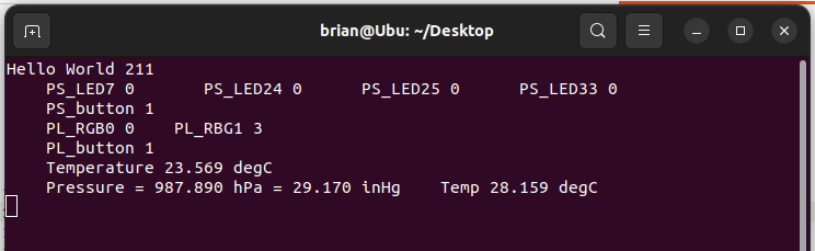

Now we want to integrate the peripherals into a baremetal project.  I will attach the application code directly, and make some notes on its use here
  • See the ZUBoard_app.c (zipped) for project source, it is attached to the review
  • PS and PL peripherals use different code in the application to setup and use.
  • This full baremetal application should be helpful to determine the minimum required code to interact with each peripheral.
  • Sometimes it is easier to strip out than to add, I think most features are modularized well enough to help.
  • Note that I did not implement the SW4 bank input switches. I find these tiny switches to be problematic (I have broken them before, argh). If you want to include them in your design they are PS (MIO) pins 31, 39, 40, 44. The same setup process used for PS_button can be used for each of these signals.
  • The manipulation of counter value looks complicated but after it is dissected, it is hopefully obvious what I am doing.
    • First thing is to undertand the ternary operator in C -> result=(logic)?(value if true):(value if false)
    • Reminder that == is a logic 'equal to', where = is an assignment
    • Consider the 3 least significant bits (LSb's) to determine the value (counter&0x7) or (counter&0x3)
    • I use the next 2 'more significant' bits ((counter>>3) & 0x3) to select which section we are accessing: 1=PL_RGB0, 2=PL_RGB1, 3=PS_LEDs, 0=blanking time when all values are 0
    • Hopefully this will make it more clear how I use 'counter' to walk through the LED outputs
  • The pressure device also includes a temperature reading.  It always read much higher than the discrete temp sensor device.
    • I do not think there is any issue with the device or my math, temperature deltas are common in this type of environment

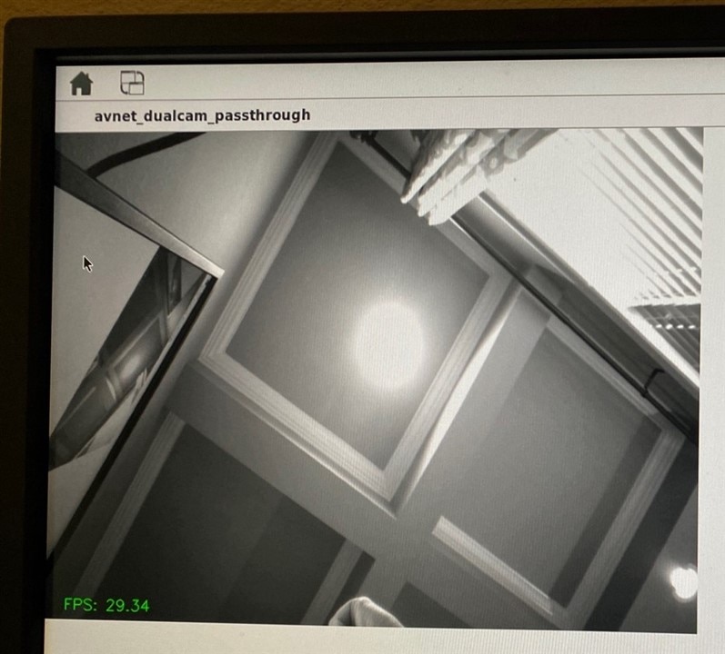

UPDATE: First Look at the AES-ACC-DPEMMC-G DisplayPort & eMMC module

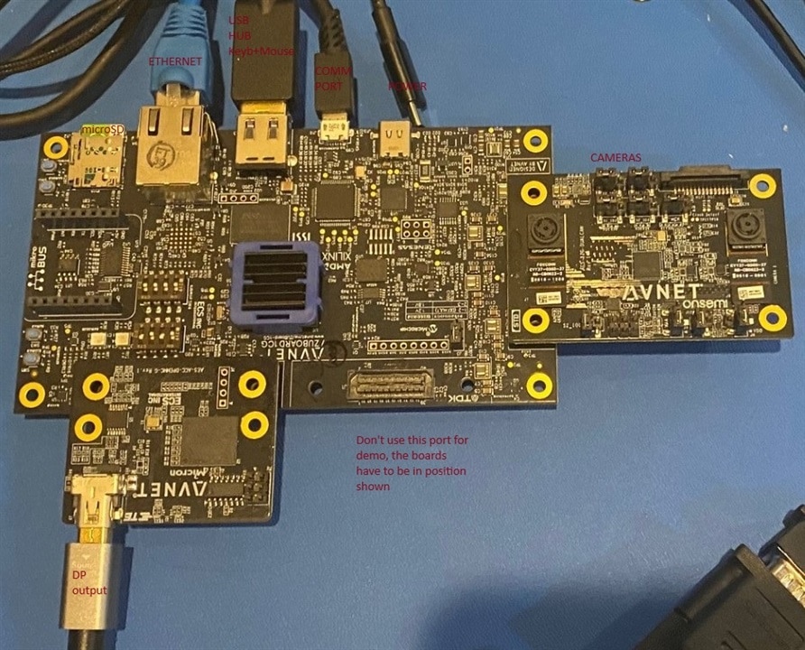

Very happy to continue my journey with the ZuBoard 1CG eco-system, I had the opportunity to try out the new add-on module
Hardware used in this review
  • Avnet ZuBoard 1CG
  • Avnet AES-ACC-DUALCAM-G add-on board
  • Avnet AES-ACC-DPEMMC-G add-on board
  • >=16GB microSD Card
  • Ethernet cable, Keyboard, and Mouse
  • USB 2.0 cable (A to micro-B, this is probably the most common cable type)
    -AND-
  • DisplayPort capable monitor
  • MINI DISPLAYPORT to DisplayPort cable
    -OR-
  • (from Amazon) BENFEI Mini DisplayPort to HDMI, 4K@60Hz Active Mini DP to HDMI Adapter (Thunderbolt Compatible) with MacBook Air/Pro, Surface Pro/Dock, Monitor, Projector
    • Section with important discussion on this later, recommend to check this before ordering
  • (from Amazon) Suckoo replacement HDMI Female to USB3.0 Male Audio Video Capture Card Live Streaming Recorder MS2130 HDMI2.0 Capture Card Device Connection USB Computer Host Laptop Docking Adapter Converter
  • HDMI cable
Initial Setup
This RoadTest UPDATE is specifically for the DisplayPort feature of AES-ACC-DPEMMC-G board. I will assume familiarity with the ZuBoard and the DUALCAM add-on, we will follow some instructions from that kit.
The DisplayPort module is capable of extending the DUALCAM reference design, so we will use this to get going. I will go through the setup and show some of the things I learned along the way.
In the AES-ACC-DPEMMC-G box:
I found there is also a second web page at http://avnet.me/dpemmc-pdp, with some additional documentation, I expect this page might merge at a later time. It says there is a reference design available, but it links back to the first page again. Actual example design is part of the documentation for ZuBoard, it is also linked below as part of instruction.  https://hsio-dualcam.readthedocs.io/en/latest/index.html
Important: Board connection for DisplayPort is a 'MINI DISPLAYPORT' version, so make sure to check this if a cable is required.

Connect as shown, and use the added labels as reference.
For future reference, confirm the Jumpers on the DualCam module are configured as shown

We can now run the demo after boot and login using MobaXterm over ethernet (so that X11 displays locally)
(from avnet examples folder)
python3 ./avnet_dualcam_passthrough.py --fps
get about 10FPS with dual 640x480 cameras
python3 ./avnet_dualcam_passthrough.py --mode primary --fps
single cam 640x480, about 20FPS
python3 ./avnet_dualcam_passthrough.py --mode dual --width 320 --height 240 --fps
dual cam 320x240, about 60FPS
python3 ./avnet_dualcam_passthrough.py --mode primary --width 320 --height 240 --fps
single cam 320x240, about 60FPS
