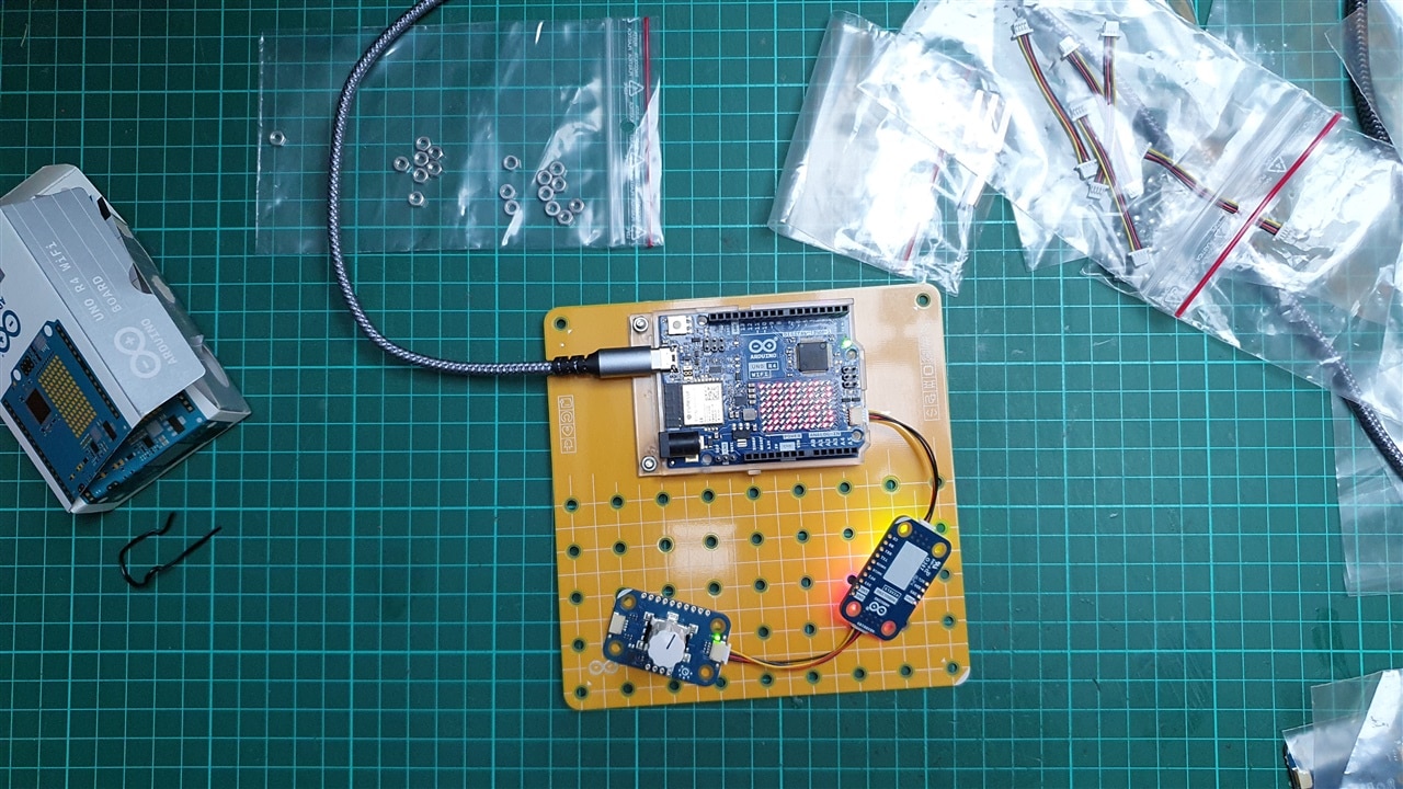

As you can see, this kit comes in quite a big box (16.5 * 16.5 * 11.5 = 3131 cm3) but most of it is empty. This is nice as a big box “Christmas present” but I have a hard time figuring out what’s the added value in storage space.
As I first opened the package like a book, I saw that there was nothing on the left part, despite drawings of the various modulino modules. This led me to believe the package was missing some key components and I was almost about to send a follow up message about it.
But then I turned to the right part and ok, everything was on that side but quite a few Modulino modules slipped off their plastic bags which does not feel “clean” for this kind of package aimed at beginners. I’m also surprised by the kind of plastic bag used, usually antistatic ones are more opaque than this with a silvery glare.

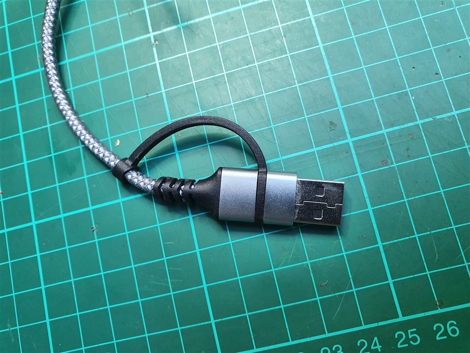

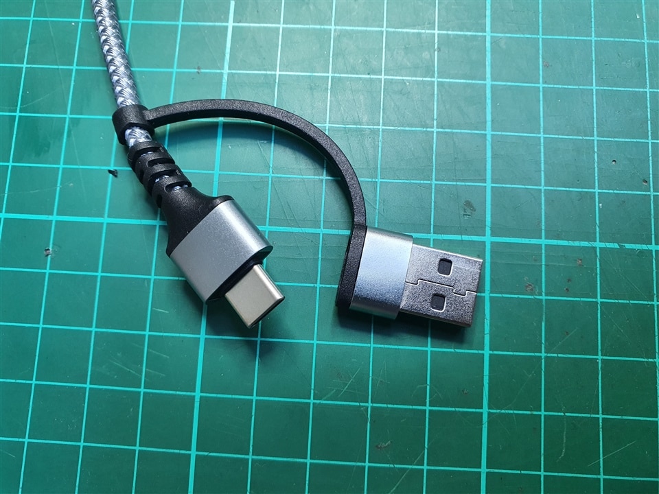

USB C to USB A/C cable
This cable is there to connect the R4 to the host computer. As it is braided, it should be more durable than the standard ones. Also, it quite cleverly contains an embedded A to C adapter on one end, catering for both computers that only have USB-C or more ancient USB-A plugs.

Modulino Base
A large PCB plate without any traces but lots of holes that match the size of modulinos. Note that if you want to fit everything on the plate, you must be quite creative with placement, here is a possible solution:

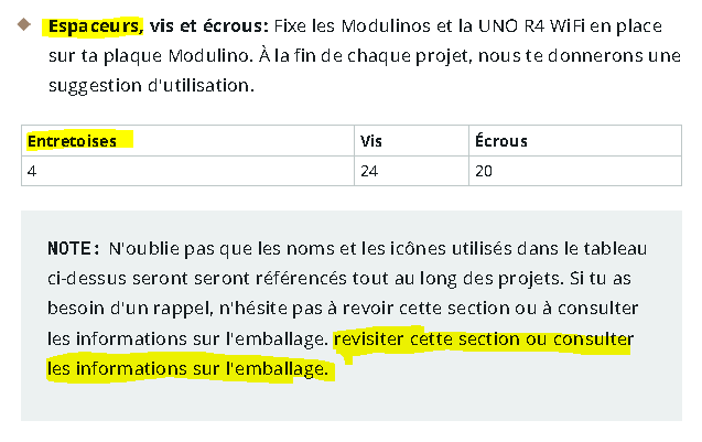

Spacers, nuts and screws
There are also 4 spacers, 20 nuts and 24 screws to be used as a means to maintain the R4 and modulinos on the base board. The number of these seems a bit off at first but I believe the extra 4 screws are meant to be mated with spacers even if there aren’t many explanations about that.
Using screws is fine when doing a “final project” version and you don’t want anything to come loose, but for a beginner friendly approach, I believe a “click” approach would be easier. Something friction based, like toy bricks would be awesome, even more if it was compatible with the main brand in this domain.

Being a native French speaker, I appreciate that they are available in French. Sadly, they are clearly machine translated and not reviewed by a native speaker. It does the job though, at the cost of some strange “child-like” language and weird inconsistencies non-English speakers have come to get used to even if it makes us smile or cringe a little.
