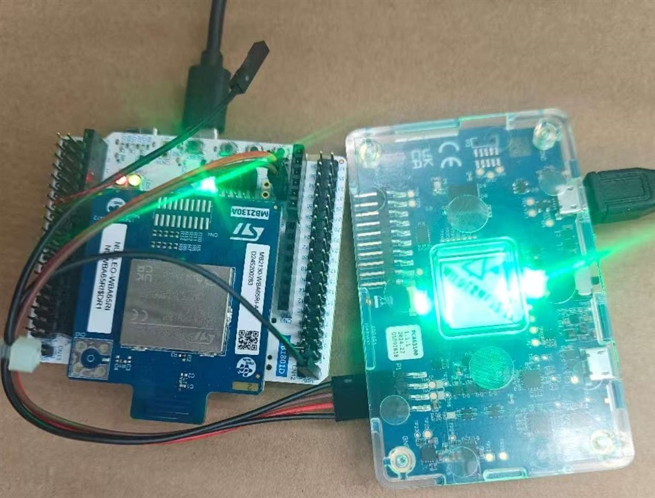

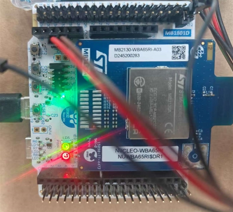

| PPK2 System | PPK2 PCB, 2x 5V micro USB cables, bundled jumper cables, 10-pin logic port cable | Current measurement, power supply to STM32WBA65 |
| DUT (Device Under Test) | STM32WBA65 Nucleo Board (NUCLEO-WBA65CG) | Low-power Bluetooth LE SoC for power profiling; |
| Supporting Hardware | External power supply (0.8V–5V), | Provide VCC for PPK2’s ampere meter mode; |

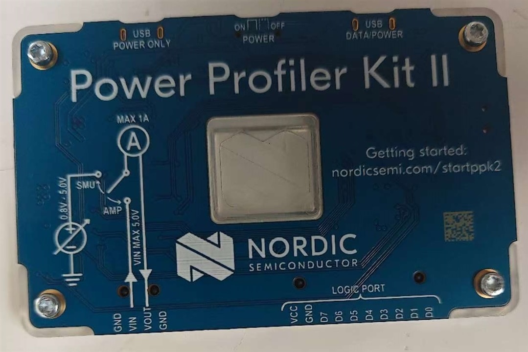

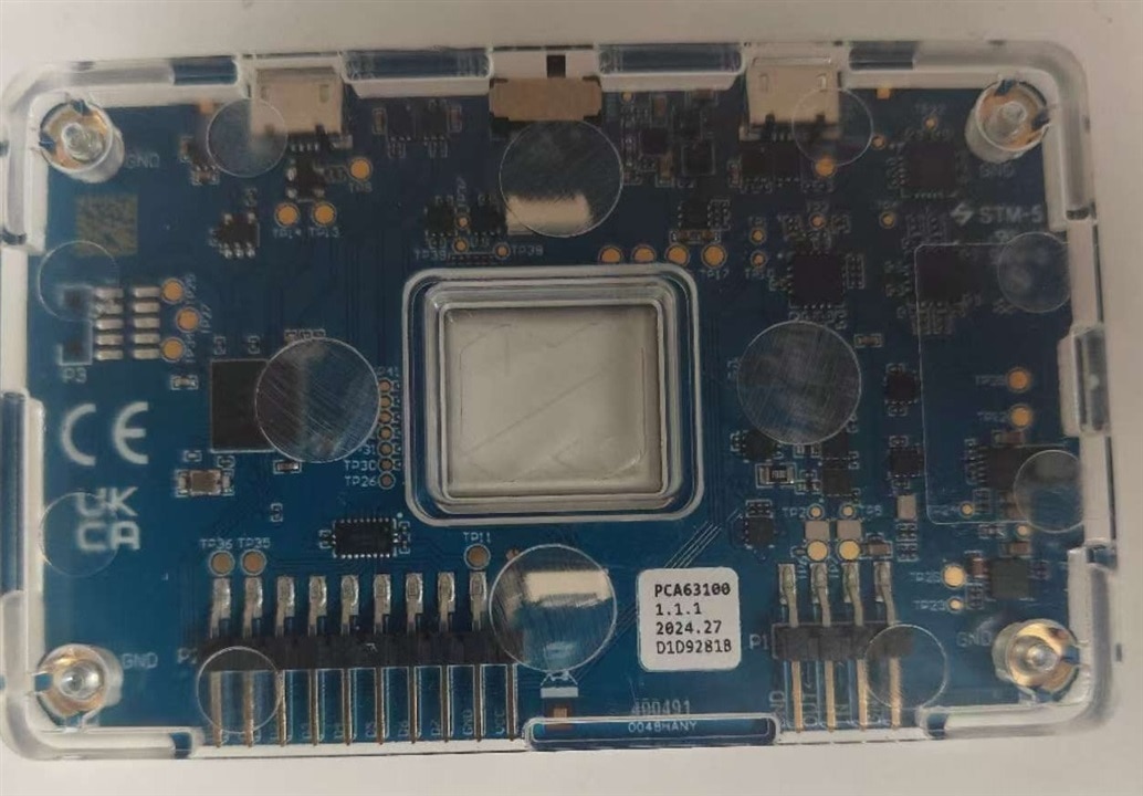

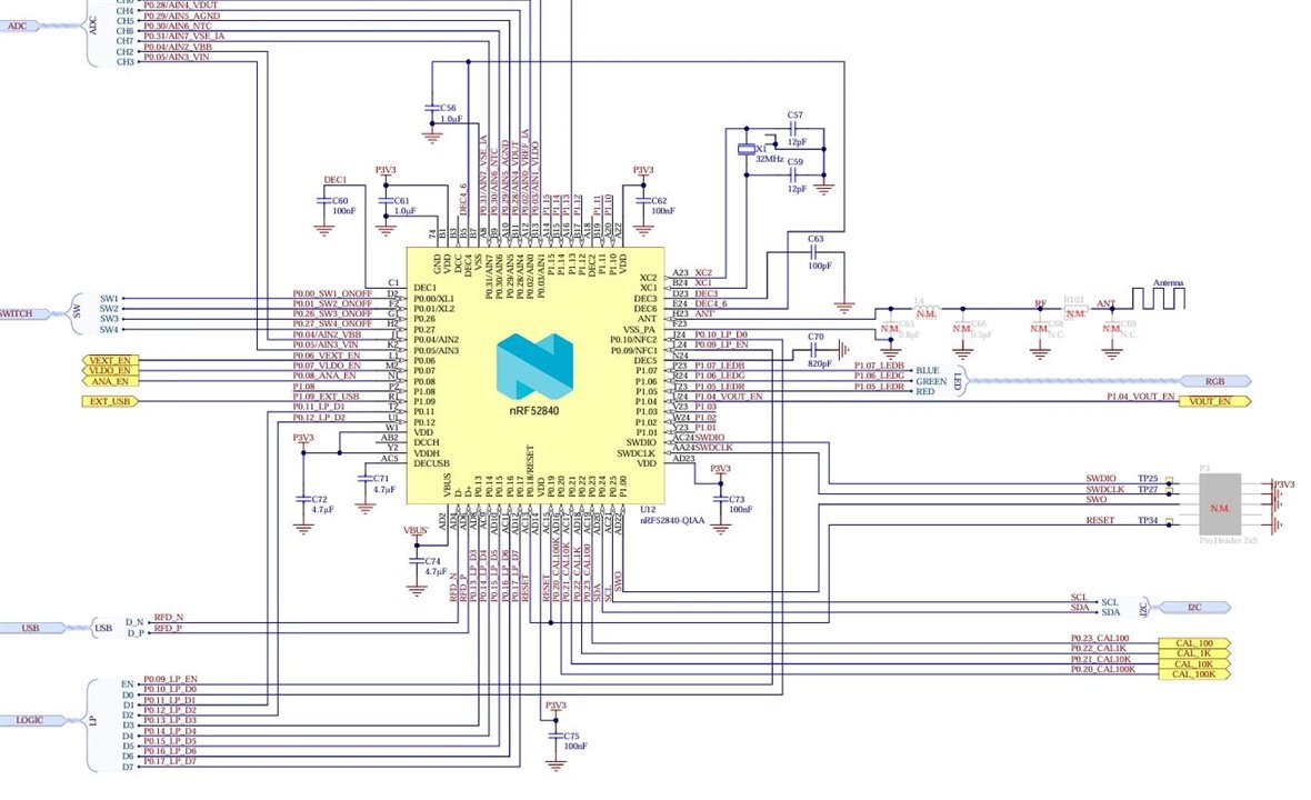

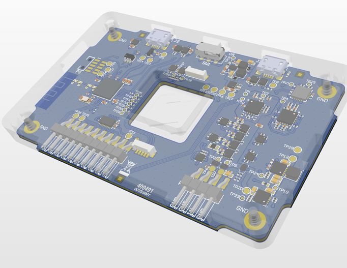

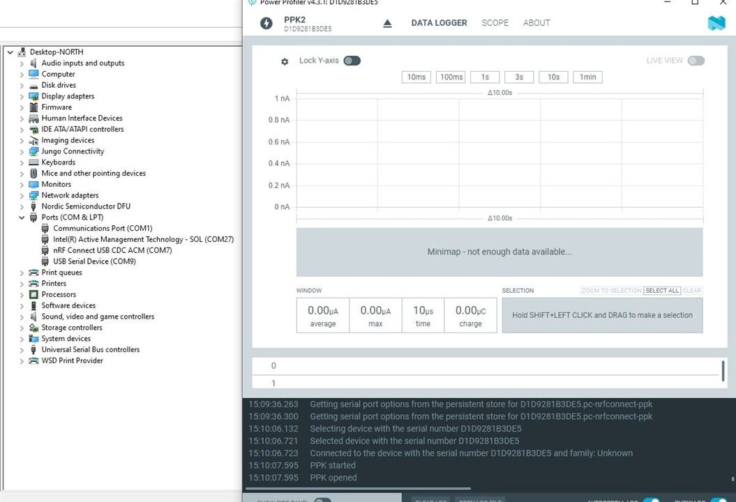

The design of PPK2 is neat and clever
nrf52840 is used as core engine

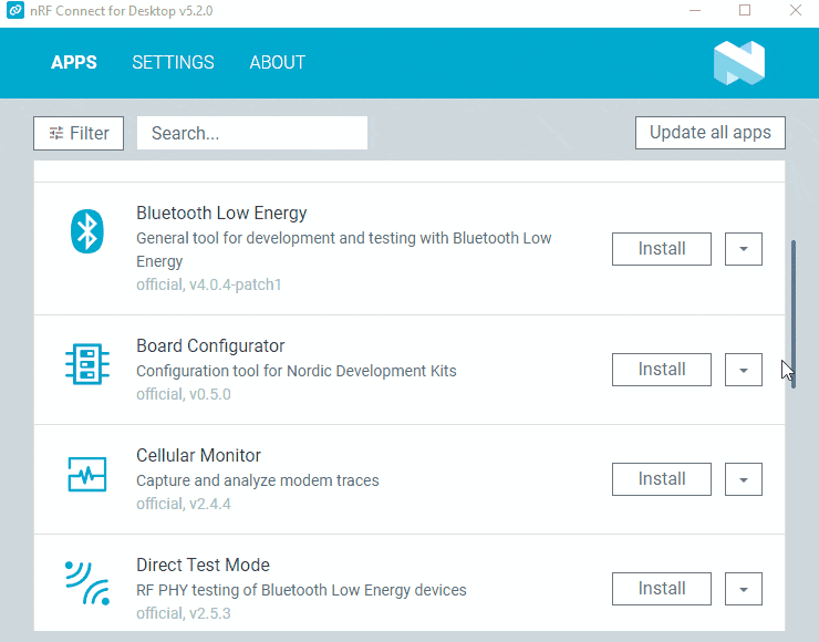

nRF connect for desktop shall be installed first and find power profiler at the bottom and press install to install the APP
then press open, the power profiler application is open and ready to work

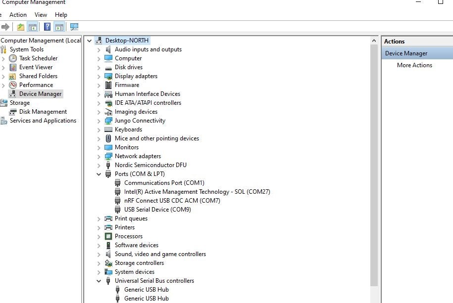

5.1 Plug the PPK2 and wait for driver to be installed automatically , until new port appears in Ports

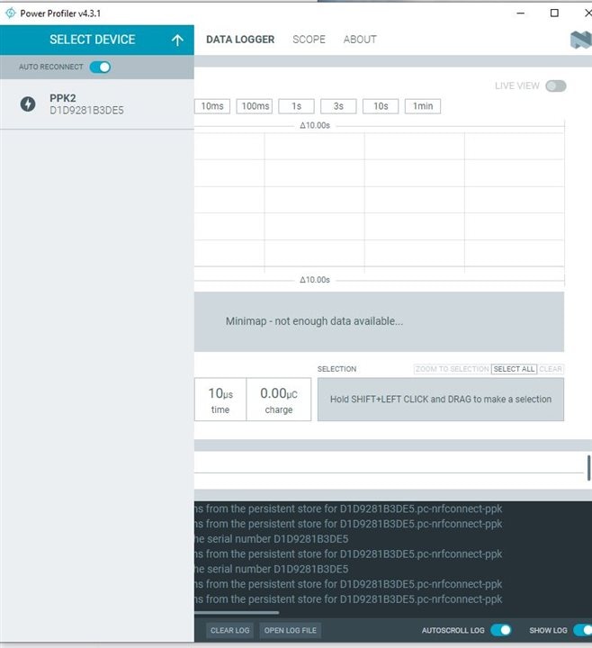

Here the the start up page, press select device, the PPK2 with ID number is shown

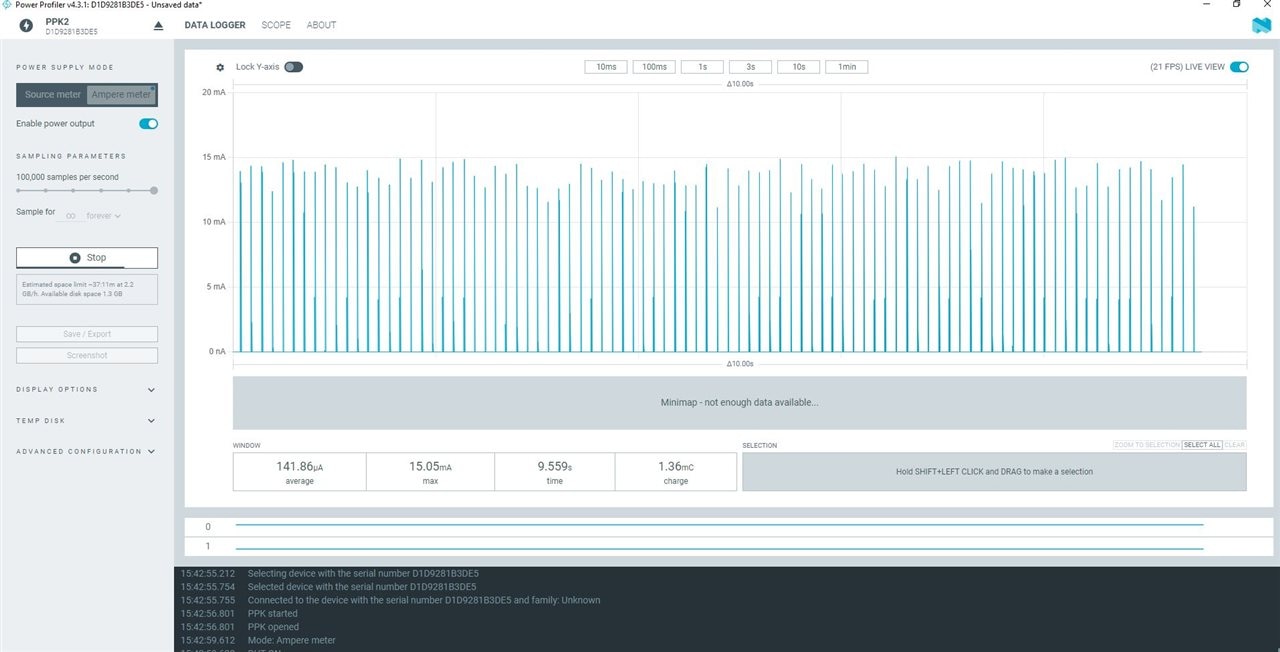

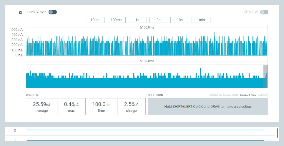

Once connected, the data logger dashboard and scope dashboard can be viewed, if not connect correctly, there is no data shown here
If connect in good mode, the data can be read from the view panel for detail graphic view and the data can be output in text format,
5.2 Test in ampere mode

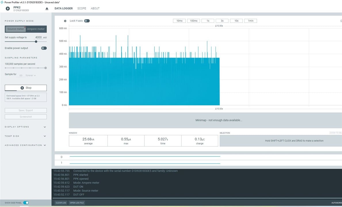

5.3 test in source mode

| BLE Mode | PPK2 Measured Current | STM32WBA65 Datasheet Spec | Error |
| Stop Mode 3 (radio off) | 0.85μA | <1μA | ≤15% |
| BLE Advertising (1Mbps, 100ms interval) | 18.5μA | 18–20μA | ≤2.7% |
| BLE High-Throughput (2Mbps, 1kb/s) | 42.3μA | 40–45μA | ≤5.7% |
| BLE Long Range (Coded PHY) | 25.8μA | 25–28μA | ≤3.2% |
6.2 The logic analysis is not tested since I have not found out how to used it, I shall dig the nRF document web furthermore. And the conclusions list below,
PPK2-STM32WBA65 Compatibility: The PPK2 accurately profiles the STM32WBA65’s low-power modes (sub-uA) and active Bluetooth LE modes (mA), with measurement error within ±6% across all tested scenarios. Its 100ksps sampling rate and logic analyzer function are particularly valuable for optimizing STM32WBA65’s radio-related power consumption.
