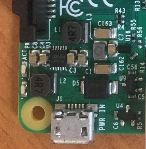

The new Raspberry Pi 3B+ also feature the custom design PMIC (Power Management IC) that simplify the power supply design. The beefy PMIC is the main reason why the same BCM2387 chip can go extra 200 MHz to 1.4 GHz and generate less heat compare to the older design
(Left : Pi 3B+) (Right : Pi 3B) The new design result in a much stable computing performance and reduce the chance we seeing the Lightning logo on the Raspberry Pi desktop due to under power as it operated. However, as the the new Raspberry Pi 3 B+ feature extra 200 MHz (1.4 GHz vs 1.2 GHz), extra Wifi feature and the 3X speed increase at Ethernet performance, I strongly recommend getting a official Power Supply Product LinkProduct Link From my testing, the new Raspberry Pi 3B+ is much stable and 15-20% faster overall once you plug in all the USB keyboard mouse and display, the total power draw might go up to 2A during heavy usage. |

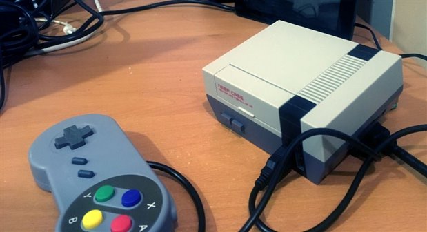

RetroPie is a community developed operating system that based on EmulationStation. RetroPie design to run retro arcade/console game emulator with gamepad controller in mind.
RetroPie is best run with Raspberry Pi 3 B+ because of the higher CPU speed help running the game smoother and support more modern game console emulation.
I using retro game case call NESPi Case and it have USB Hub and power switch build in. The gamepad i use is Buffalo USB retro gamepad.
You can play open source game or game ROM easily by just copying the ROM file through network share \\retropie.

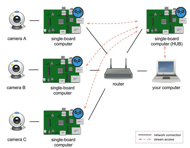

Motioneyeos is a light weight video surveillance system that build for low power device like Raspberry Pi. You can use standard USB webcam or Raspberry Pi Camera Product LinkProduct Link for it.
One of the key feature of Motioneyeos is the ability to track movement and record multiple video stream from each video source, the beefy Raspberry Pi 3 B+ have the CPU power and 1GB memory and high speed internet just perfect for this purpose.
I am using a few Raspberry Pi Zero W v1.3 with the official Pi Zero case that come with camera mounting and cable, together with a low cost Raspberry Pi Camera module (Product LinkProduct Link).
The Raspberry Pi 3 B+ will act as command center and received all video feed from the Pi Zero W and process them accordingly and done further analysis on it.
The road test Raspberry Pi 3 B+ is mount in the official raspberry Pi case (Product LinkProduct Link) and I drill a hole and glue the camera module onto the case itself.
The Motioneye Hub require higher CPU power and higher internet speed as all the data will be passing through the hub to be view and manage by a single website address.
