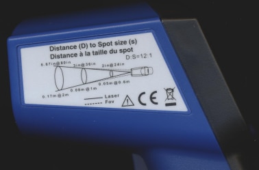

There was a plan to do a tip temperature evaluation. The test procedure would monitor the tip temperature during the warm-up cycle while recording the time and then establish the final tip temperature and time. Two different temperature probes were used for the test in addition to purchasing a temperature gun. All the temperature tests failed.
The temperature probe from the electric oven kept shutting down because the oven considered the probe in error. The second probe for measuring meat temperature didn’t have a high enough temperature range.
Why doesn't this gun provide temperature reading? Hope I can get a refund.image
A temperature gun was purchased from a local store with the intent of measuring tip temperatures. It would only read a maximum of 35 Celsius. The same result was obtained using a friend temperature gun. I would be interested to know why the temperature guns failed to provide a reading.

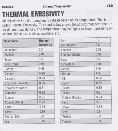

  • Thank you for the explanation. If you can respond to some questions for clarity?  To further the discussion, the manual included details on emissivity and I scanned the range specification on the unit.
    If emissivity is a factor, then why would my farmer friends suggest they use a similar unit for measuring bearing temperatures?
    I can narrow the spot size (red LED capture circle) to approximately one centimeter. To achieve this I am less than four inches from the pencil. Still the reading never went above 35 Celsius. Since the unit suggests the focal and the laser are not aligned at this point would this be the limiting factor?
  • I scanned the manual and the back packaging of the unit that provided specifications. I trust it is readable.

  • To measure soldering tip temperature, you should use a dedicated tip temperature measuring device such as https://www.hakko.com/english/maintenance/topic_fg101_a.html  As far as I know, these use a specialised thermocouple - which would be the approach I would suggest has the best hope of success.
    The reason an IR thermometer won't work reliably is because of two things - one, it infers temperature based on infrared emission assuming the surface has a particular emissivity (typically around 0.8). Metals typically don't have high emissivity (i.e. they don't radiate much infrared when they are only mildly hot), hence you're not going to get an accurate reading. This is also why the surface finish is critical for accuracy of IR thermometers. As for the other reason - the gun has a fixed focal distance and hence spot ratio. If you hold it too far, then your readings will be diluted by the cool background. If you hold it too close, there's a chance you might melt the unit (that has happened to a colleague) or the unit will heat up too much to give an accurate reading.
