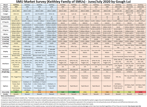

In order to understand the positioning of the Keithley 2450 SMU, on-paper specifications for bench-top style SMUs were compared. The Keithley family was the largest, consisting of the latest graphical SourceMeters, the older 2400-series and 2600-series. Of these, the graphical SourceMeter range improves on the specifications of the older series while improving flexibility through more connectivity options and programmability, while also incorporating a superior user interface through the use of a 5” capacitive touch LCD. Other vendor alternatives included Rohde & Schwarz/ADCMT, Yokogawa and Keysight, however, some of these appeared to be “unobtainium”, they generally offered lower specifications and more limited user interfaces.
As a result, it seems clear that the Keithley 2450 SMU seems appropriately positioned in the market, with leading specifications and capabilities where it matters, at a price that sits well with the Keithley family of SMUs and those from other vendors. The Keithley SMU range has different units for different needs, making choosing a Keithley SMU feel quite natural. Other vendors have a more limited range of SMUs available by comparison, with the closest match on price and specs perhaps being the Keysight B2901A which doesn’t present any compelling advantages over the 2450.

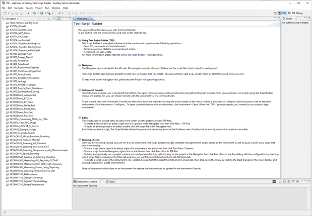

But by far the biggest asset of the 2450 are its large memory buffers, dual-dialect support for SCPI commands and Test Script Processor (TSP) commands, and implementation of TSP scripts through the Test Script Builder (TSB). This allows a break away from the traditional SCPI model of smart host controlling “dumb” instruments, which suffers from bottlenecks due to command transmission and processing latencies which often limit the speed at which these systems can operate and impose synchronisation challenges. Instead, by making a Lua-based programming/scripting language interpreter in the instrument accessible to the user, these issues can be overcome by allowing the test logic (branches, loops) to execute on the instrument directly, storing results into a capacious buffer or front panel USB. When combined with the ability to prepare and debug scripts interactively through TSB, it is a fully-featured Eclipse-based development environment for TSP scripts which makes transitioning from SCPI just that little bit easier. The authored scripts can be saved to USB for loading and executing on the SMU, thereby also allowing users to eschew the use of a PC if they desire.
The only downside to TSP is that it is a Keithley-specific feature that is not otherwise standardised, so any scripts developed are “tied” to Keithley equipment with TSP capabilities. However, that may not be such a big issue for some, as there are ways to use TSP on a Keithley instrument to provide remote control of non-Keithley instruments through the use of tspnet commands. I show how this is done in the chapter on I-V Tracer App Comparison. It’s definitely a powerful feature, and if you don’t like it, well you still have good-ol’ SCPI.

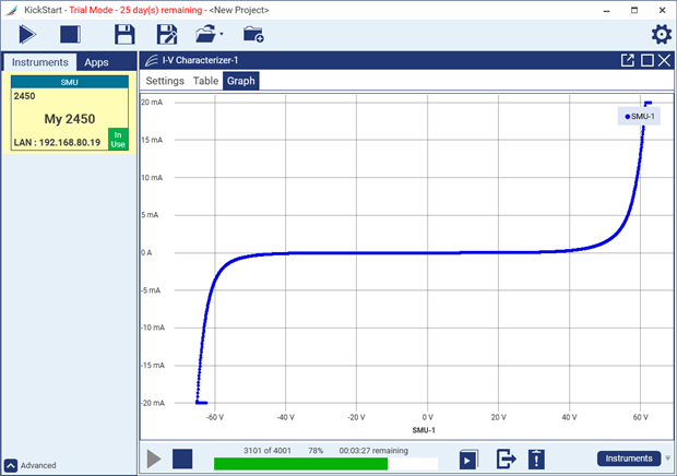

The KickStart 2 software is intended as a start-up software to let users get up and running with their instruments immediately without any programming, supporting a range of Keithley and Tektronix products including SMUs, oscilloscopes, DAQs, DMMs and PSUs. It consists of a number of standard apps and add-on apps. It is licensed as KICKSTART-FL-BASE option, with a 60-day fully-featured evaluation period which is used for this RoadTest.

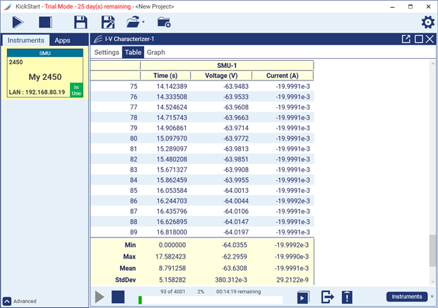

For the SMU, KickStart 2 offers a competent I-V Characterizer app that has support for multiple SMUs with most of the necessary settings allowing for customisation of the sweep type and parameters. It offers a table of values and graph which is updated in real-time as the test progresses, along with a progress bar that offers estimated times. It allows data to be exported in CSV, Excel and PNG screenshot image formats at various resolutions.

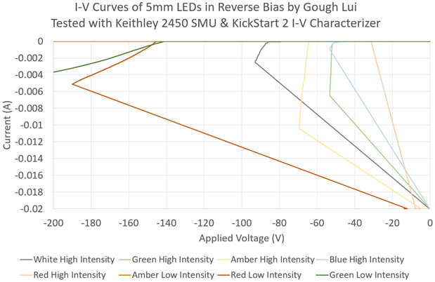

Using KickStart 2 and the 2450 SMU, I was able to characterize a variety of devices, including diodes, LEDs, metal-oxide varistors (MOVs) and NE-2 neon bulbs in forward and reverse bias. The exported data was used to build the graphs which show the differences in behaviour between different devices. The data illustrated the superior low-level capabilities of an SMU compared to power supplies and digital multimeters I had previously used, with the background current noise in the tens of picoamps even when using banana leads on the front panel. Previously, I was only able to measure down into the hundreds of nanoamps.
The software generally performed well, with some anomalies experienced likely due to hardware faults in the 2450 SMU that I received. Despite this, I noted the occasional spurious bug that required a restart of the program. KickStart 2 is also a little less flexible than I imagined, as other apps are not available for SMUs. I would imagine something like data logging, similar to what might be available for DMMs, could be easily adaptable to the SMU but is not offered. It was also discovered that the CD included contained the original version of KickStart from 2014 which had issues detecting the instrument when installed on my Windows 10 desktop machine.
Users will have to evaluate whether KickStart 2 provides the functionality and value they expect, as the price of a KICKSTART-FL-BASE license is not inconsiderable and its capabilities are still relatively limited. Of course, if one is comfortable with programming their own solutions either using SCPI or TSP remote control, such options are fully available as an alternative.

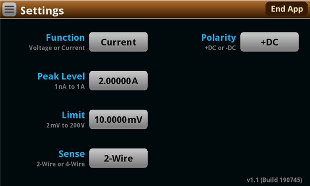

The 2450 SMU offers a number of different on-board approaches to I-V curve measurement – there is the onboard sweep generator and graphing feature, the optional I-V Tracer app and the possibility of using TSP scripting.
The I-V Tracer app is licensed as option KICKSTARTNL-ACT1 which was provided as a claim check by e-mail for redemption through the TekAMS system which generated a license file to be imported into KickStart 2. From there, the app needs to be installed to the SMU on the first use, after which it remains resident on the SMU and can be run without the computer. The claim process was a bit more complex than I had expected and after installation, the system believed I had a one-year trial even though this should not have been the case. It could be related to installation on a trial version of KickStart 2, but I was assured by Tektronix that this should not cause any problems.
The I-V Tracer app is designed to imitate the intuitive operation of a curve tracer by providing a real-time graph of current and voltage, controlled by the rotary encoder knob on the front panel. I found the set-up to be somewhat lacking, especially on the 2450. I found the feel of the rotary encoder to be less “analog” and more “digital” owing to the stepped operation. The knob “acceleration” with regards to speed of rotation is hard to gauge, since the unit plots only 2-3 points per second at the most. Depending on the limit settings, it can be extremely easy to overshoot the inflection point of the curve, requiring a back-and-forth action to try and get more resolution around this point. The output is maintained on during the trace, which means that slower tracing will result in possible heating of the device under test, resulting in deviations of the traced curve. The alternative is turning the knob slowly and consistently, but this results in a very slow trace that may wear out the rotary encoder (and your fingers). Based on my experiences so far, I find the I-V Tracer App hard to consider as a good replacement for a curve tracer, especially when used on the 2450 in its current form.
Some of these limitations seem to be specific to the 2450, because it does not have the high-speed digitisers and AC capability of the 2461, thus cannot offer quite the same experience. I have made some suggestions to Tektronix that they may consider automatically plotting intermediate points while sweeping, adjust the way the knob acceleration works or instead use the touch screen input (e.g. slide your finger to adjust sweep direction and speed) to make a more “analog” feeling tracer. After all, the SMU is quite quick with its outputs, but this app just doesn’t feel like it’s making the most of the capabilities.
Compared to the Sweep Generator and graphing features on-board the SMU, the I-V Tracer offers the user more “direct” control of how the trace proceeds, having some flexibility as to where to spend more “effort” to get clearer data. The downside is that the implementation using the digital rotary encoder and unintuitive-feeling knob acceleration makes this less ideal than it could be.
I-V Tracer can also be used with KickStart 2 connected, in which case it provides a table of data, plotting of the I-V curve on the computer and the ability to export the data. For both the I-V Tracer app and KickStart 2, a number of quirks were encountered which suggests the software could do with some additional polish.
I also explored I-V tracing a MOSFET at several different gate voltages using TSP scripting to control the 2450 to provide the Vds and an R&S NGM202 to provide the Vgs. Using the tspnet commands, it is possible to use the 2450 to also control other vendor instruments over LAN (in this case, using SCPI). As a result, it was possible to perform such an I-V trace without the need for PC connection entirely, storing the data to a locally-connected USB memory device for later processing. As someone who has never written TSP code prior to this RoadTest and has never coded in Lua before, it was exciting to see that it only took about 30 minutes of looking at references to get from nothing to a completed script. The results weren’t perfect, as it seems thermal effects and stray charges may have affected some of the curves, but the SMU shows impressive low-current resolution in this test as well.

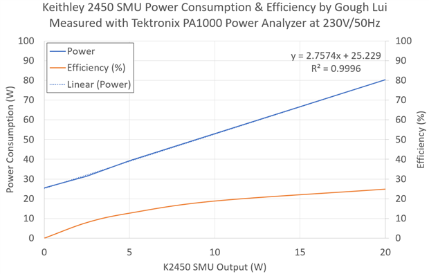

The downside of the SMU is that its power consumption and overall efficiency are lower than an ordinary power supply. At 230V, 50Hz supply, the 2450 idled at around 25W with each Watt of output costing about 2.76W, reaching about 80W when sourcing 20W. The peak efficiency measured was 25%. While efficiency may not be the primary concern of an SMU user, this is perhaps something that is not obvious and is to be borne in mind in case you intend to be using many of them for automated testing in a rack due to power and thermal concerns.
