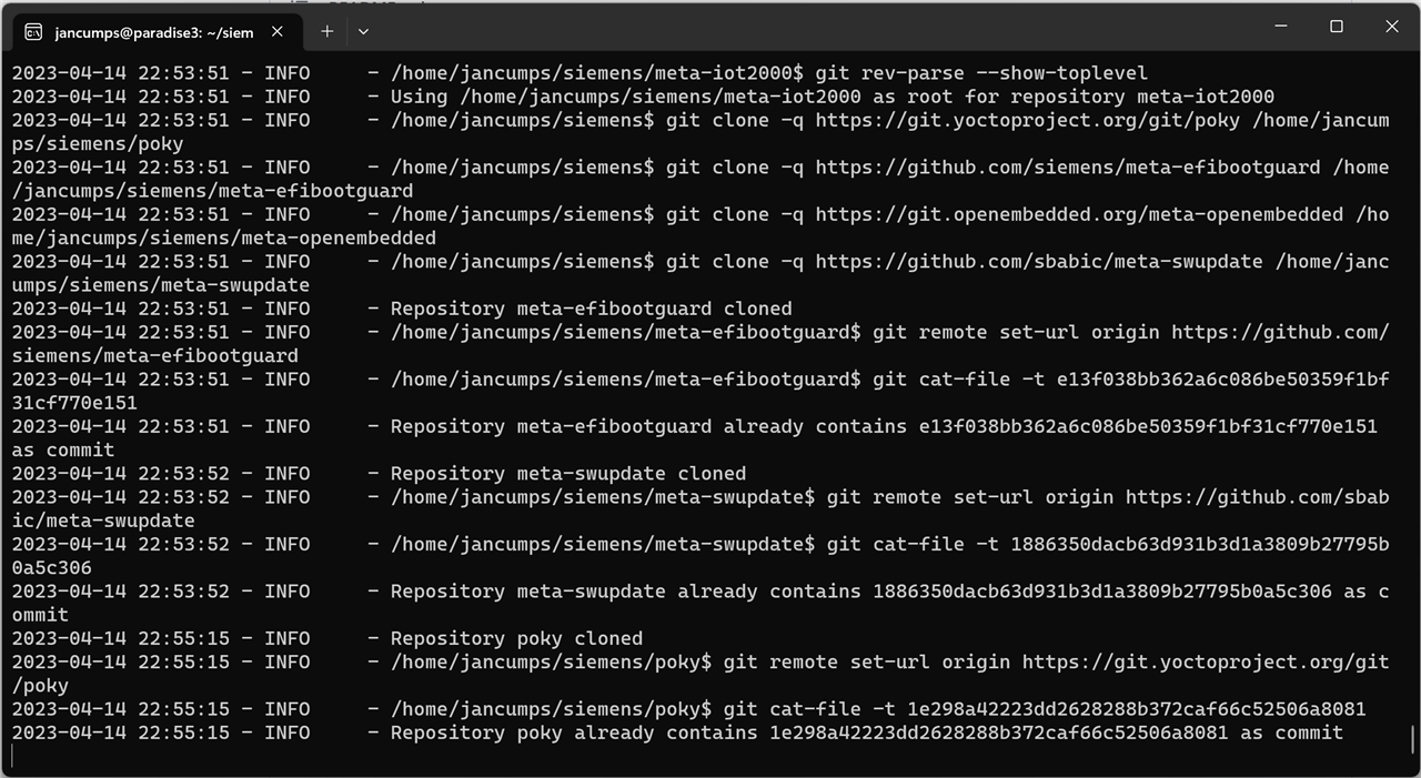

    Success. I was able to generate a fresh-from-source image, with some personal adaptions.
    For self-training and to check if it actually is doing what I expect to do, I changed the out-of-box IP address that the device will start up with (github commit).
    I had to throttle down the number of processors that the WSL Ubuntu (the platform that I use to build the Yocto image) could use, because I ran out of memory during the build:
    wsl --shutdown
    notepad "$env:USERPROFILE/.wslconfig"
    [wsl2]
    memory=12GB # Limits VM memory in WSL 2 up to 12GB
    processors=8 # Makes the WSL 2 VM use 8 virtual processors
    I'll now write an SD Card and test it ...

    Jan Cumps over 3 years ago
    Solved by using an older Ubuntu (20) with Python 3.8.
    The source base isn't compatible with Python 10:
    AttributeError: module 'collections' has no attribute 'MutableSet'
