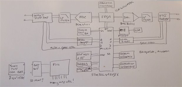

Hi I'm looking for ideas on an update to a resistivity meter for archaeology. The only published designs for diy were in 2 magazines. One was published in 1997 and the other in 2003. I have copies of both articles available. The reason behind this is the current high cost of available equipment, usually well beyond the reach of most archaeological groups. I've attached a basic block diagram. In the first magazine article the meter is very basic. It relied on the operators to write down the reading given as the survey was taken. Given that a normal survey grid is 20m x 20m and 1 reading is taken on every sq mtr there would be 400 readings to write down and then input into a program used to interpret the results. The later article is really an update to the first where a PIC has been added to record the readings. This again is prone to error, because eadings are taken manually by pressing a button.
I'm sure given the advances in electronics there must be better ways.

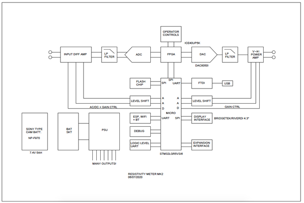

    Hello Ken,
    mk2 block diagram.
    Several changes,
    The DAC is driven by the FPGA
    The ADC has changed type to a TI single channel audio type (much cheaper (about £3.30) and OK for our purpose I think.)
    The ESP chip provides Bluetooth and WiFi, chosen because its widely available, dead cheap and there is a lot of app material on the web.
    The battery type is defined as Sony NP-F970 equivalent, 5AH gives about 35Whrs, and I estimate a WiFi and display on power
    consumption of 3W so the available batteries should give at least 10 hours per charge. I bought 2 and a charger for about £40.
    The display is ideally a Riverdi 4.3" which uses the Bridgetek controller and has SPI interface. You can get a bare bones one for about £36
    but the nice one with the touch screeen and flat glass front (like the PI display) is about £50. Or you can use a sub £5 quarter VGA type from
    China - but I won't be writing code for it image
    Any illegible and unguessable features, please ask.
    MK

    kltm over 6 years ago in reply to michaelkellett
    Looks great, I'll draw it up this evening.
    Hi Michael
    Just posted block diagram. I hope there's not too many mistakes.
