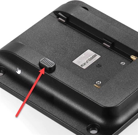

    shabaz over 6 years ago in reply to davemartin
    Hi Dave,
    That's very useful information. I've noticed the same thing, my low-cost charger doesn't have that latch either.
    However the battery-plate that I've ordered from aliexpress does have it (at least, it looks like it from the photo), so I'm hoping that works. Still, I wouldn't trust that on it's own with this cheap battery plate, and there may need to be some 3D-printing for a screw-on battery cover perhaps (maybe with foam padding), or some damping ideas, since so many knocks can't be healthy for the battery.
    There are better battery plates on Amazon, but the price is higher. Since the battery is a standard voltage dual-cell device, worst case the battery and the plate could be swapped out for a different option when testing too, or constructors may be invested in a different battery system (e.g. Canon) and so they might use that anyway.
    Although, not that I'm an end user for this project, but if it were me I'd prefer Sony over Canon because the battery has easier-to use connections (large round sockets, whereas Canon batteries [at least the ones I've seen] use metal leaf connections).

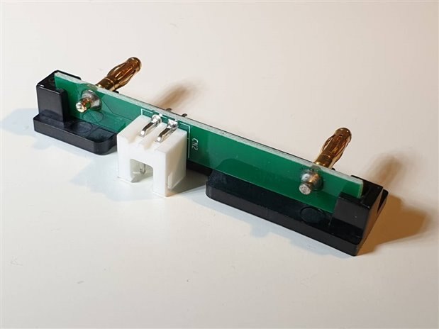

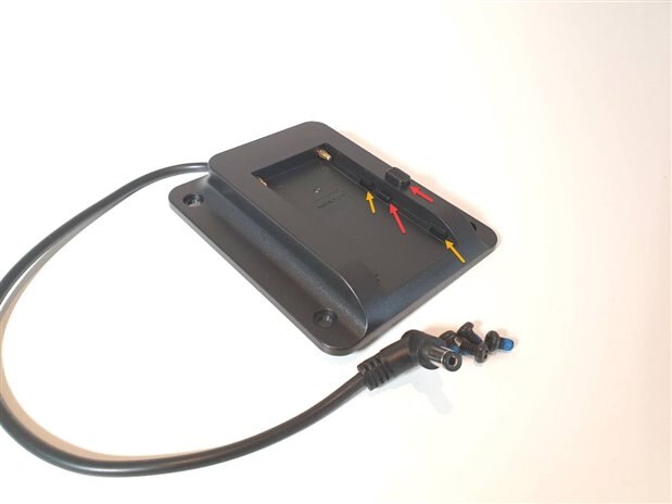

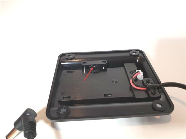

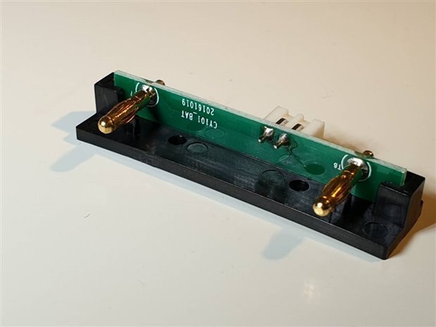

    The aliexpress battery plate (search term is Andoer Battery Adapter Base Plate Battery Plate for Lilliput FEELWORLD Monitor for Sony NP-F970 F550 F770 F970 F960 F750 Battery in case the link goes bad) arrived.
    It is made as well as any typical consumer item. The battery I tried is held with zero wobble, and the latch mechanism worked to prevent it sliding off. The wire is heavy gauge too, and battery contacts are nicely made.
    There are photos below but in brief, I think it is good value, I wish I'd ordered another couple.
    The yellow arrows show the slide-on hooks, red arrows show the latch.
    The latch spring is visible here:
    The battery contacts have springy curved metal like banana plugs:
    Some epoxy glue on the back of the pins could be useful maybe, for extra strength. The connector is JST PH.
