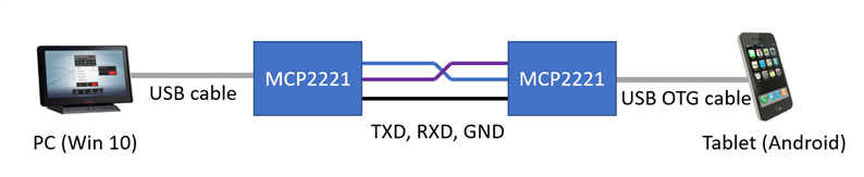

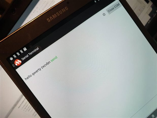

    shabaz over 6 years ago in reply to shabaz
    115200 baud confirmed functioning.
    So, one day the snuffler software can be replaced (or at least partially) with Android code if desired. Or could be used to e-mail or upload the data in real-time so someone can remotely check it while the survey is still being performed.
    The test setup was as shown here:

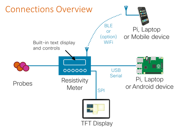

    shabaz over 6 years ago in reply to paul_d_arch
    Hi Paul,
    I like using Python too. It will be awesome to see what code could be used or developed for this project.
    This is a rough sketch of some (not all) of the connectivity methods and how they might be used:
    GPS expansion will be feasible by plugging the GPS module directly into the Pi, but it might become unnecessary, since there's the possibility of either sending GPS position from a phone (via Bluetooth or BLE) or sending the measurements into the phone. The only limitation is what's coded, since the underlying hardware covers lots of popular interfaces (USB, BLE, etc). There's memory on-board too, so in theory the data is reliably stored and the SD Card is for transferring stuff (edit: there's no SD card option, it's unnecessary since there are better wired and wireless options) . Also, if it's more comfortable for someone to analyze remotely from a larger computer, then any captured data can be sent in real-time from the phone - assuming it is coded!

  • michaelkellett
    michaelkellett over 6 years ago in reply to shabaz
    I wasn't thinking of supporting an SD card interface, unless others feel this to be essential:
    1) The low power Cortex M4 processor doesn't support it
    2) If we change processor to one that does we'll need probably to go to 144 pin chip
    3) The code to support SD card is complicated
    4) You have to support a full on disc filing system
    5) Could use a support chip as Gene suggested but it will use a lot of pins.
    6) All the above if we support USB OTG except the low power processor is OK with it.
    Probably not clear on my original block diagram that the options in the dotted processor outline might need to use a different processor.
    On the other hand if we go for a more powerful processor we do get the benefit of faster processing all the time. The H7s support
    dual voltage SD card at up to 104MHz - there is some free software from ST which seems to support FAT.
    An H7 will burn more power speed for speed and about 300mW more at full (400MHz) speed.
    See ST app note AN5200
    I'm agnostic on this one - I've got quite used to STM32H7s now image
    MK
    • Vote Up +5 Vote Down
