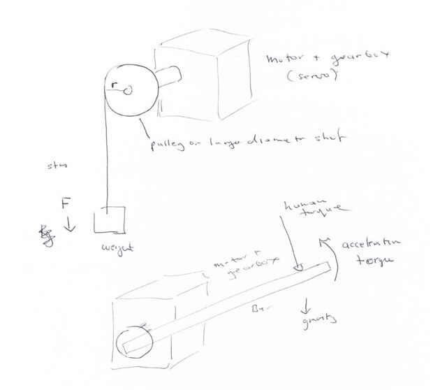

I apologize for what is likely an ignorant question, but I am fairly new to electronics and have little confidence. I am working on a personal project where I am using a servo motor to move a rod back forth 90 degrees (not exactly, but this analogy should suffice), and I am interested in measuring the instantaneous (angular?) acceleration (I want to use it to calculate torque). Surprisingly, I have come across trouble while researching online for a sensor to do this. My understanding now is that an accelerometer is only capable of measuring linear acceleration (which means the object can't be rotating, right?), while a gyroscope only measures angular velocity when an object is spinning about an axis. Technically, the rod in my project isn't spinning-it's just rotating back and forth between two angles (0 and 90) on the XY plane. Is there a simply way/sensor to do this? More broadly, am I completely misunderstanding the uses of gyroscopes and accelerometers? I hope i explained the issue properly...

    @ John,
    torque=moment of inertia * angular acceleration, true, but only applies to the torque needed to move the bar, tells you nothing about the torque applied by the human.
    If the bar has significant mass you will need to measure the torque applied by the motor, subtract the bar acceleration torque and possibly subtract the torque due to  gravity acting on the mass of the bar.
    I've attached a pair of drawings produced on a special high tech mechanical simulation package. The top sketch shows the calibration setup. The lower sketch shows what I think your set up looks like (how about some photos from you - it would help).
    Remove the rod to calibrate, the servo should be holding the weight still so the force of the servo is balanced against the force of gravity acting on the weight.
    If the pulses from the current sensor are too fast then integrate them with a filter (anything from an RC to something active and exciting but without numbers I can't advise).
    MK
